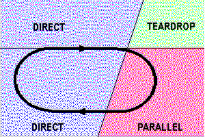

Some pilots can visualize a holding entry only by sketching itright on the chart. That's certainly an option, albeit an awkwardone. Another way to accomplish the same thing is to put the DGor HSI to work as a visual aid. Even pilots who busted patternanalysis on their aptitude tests can manage this one.
Step one, as shown in thedrawing, is to divide the DG into segments that correspond toteardrop, parallel and direct entries. To do this, strike an imaginaryline across the face of the instrument that's 70-degrees off thevertical. (Or 20 dgerees of horizontal, if your prefer)
For standard turns to the right, the right side of the line shouldbe angled upward (as shown). For left turns, the left side shouldbe angled upward. Another imaginary line extends downward fromthe DG's lubber line to the angled line, dividing the upper halfof the instrument face into two segments. Next, get establishedon a heading towards the holding fix, be it a VOR, NDB or intersection.To determine the entry type, just read the numbered radial orbearing specified in the holding clearance along the outer ringof DG compass card. If the radial falls in the teardrop sectorof your imaginary DG segments, use a teardrop entry; if in theparallel sector, use that type of entry and so on.
If you're holding at an NDB, make sure you're clear on whetherthe bearing given is TO or FROM the beacon. Published NDB holdsover approach fixes usually depict the inbound course so if theDG-crutch method is to work in this instance, plug in the reciprocalalong the DG's card.
Although this method is nearly foolproof, you do need to rememberwhich direction to turn to both begin the entry and to interceptthe inbound course. One trick is to visualize the inbound courseas a line extending from the outside of the compass card to thecenter of the DG. It should then be obvious which way to turnto start the entry.
