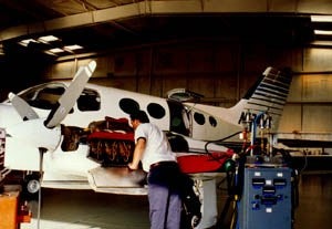

Preflighting a Cessna 414AConsequently, the enginecompartment needs to be looked at carefully…and often. Giving it a careful going-over ateach 50 hour oil change is simply not enough. Some aircaft — notably Bonanzas and TwinCessnas — have big hinged engine compartment doors that allow quick and easy preflightaccess, and these should definitely be opened up at preflight before the first flight ofthe day. Other aircraft (including most Cessna singles) make it a lot harder to preflightthe engine compartment. But even on these models, I recommend pulling the top cowling atleast every ten hours or so.
What should you look for in there? Definitely look for stains of all sorts: fuel, oil,and exhaust. Fuel stains are normally blue (if you use blue-dyed 100LL avgas). Oil stainsare, well, oily. Exhaust stains are generally brightly colored: mostly yellow, orange orred. Stains are almost always a tip-off that something’s wrong. Even if the stains aresmall ones, don’t fly the airplane until you’re sure you know where the stain is comingfrom.
If you’re absolutely certain that small oil leak is coming from a bad rocker covergasket, it’s probably okay to fly now and replace the gasket later. But if it’s comingfrom the a cracked oil cooler, oil filter adapter, or from cylinder, then it’s definitely notokay to fly! So make sure you know the source.
Also inspect the engine compartment and nacelle exterior for signs of heat distress.Hidden exhaust leaks can be killers, particularly in turbocharged aircraft. TurbochargedCessna twins have an especially dismal history of exhaust-related fatal accidents. Alsolook for signs of chafing where hoses, wire bundles and control cables come into closeproximity to the engine or each other. If you see two things rubbing, isolate them with atie-wrap or clamp before you launch, lest the chafing continue and cause a serious problemin-flight.
Fuel contamination is another killer that needs to be caught at preflight. If theairplane has been out in the rain or fueled from underground tanks, you need to beespecially careful about draining all the sumps (including aux tanks and crossfeed lines,if applicable) until all water has been removed. Don’t drain the sumps onto theground…drain them into a jar or fuel tester so you can see what you’ve got. (I use a”GATS jar” from Sporty’s.)
I also recommend sniffing the fuel you drain to see if you can detect the odor ofkerosene. My Cessna T310 was once misfueled with Jet A and I’d probably be dead now if Ihadn’t caught it before flight.
If it’s wintertime and you can’t get fuel to come out of any drain, the reason may bewater contamination that has turned to ice and plugged the drain. Don’t fly until theairplane has been thawed and drained thoroughly. Most manufacturers recommend addinganhydrous isopropyl alcohol or ethylene glycol monomethyl ether (EGME, sold as”Prist”) to the fuel to prevent fuel system icing. See your POH for details.

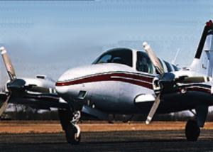

Beech Baron 58Injected Continentals are typically very easy to start. The auxpump and injector nozzles provide optimum priming right at the intake port of eachcylinder. Flip on the battery, alternator and mag switch; advance the mixture and prop tofull-forward; advance the throttle a bit; then crank while priming with the electric fuelpump. The engine should start within a few blades’ rotation. As soon as it does, releasethe starter and prime switches immediately…especially important if you have a Bendix”Shower of Sparks” ignition system, since the mag timing remains retarded untilyou release the start switch.
If it’s cold out, a bit more priming than usual may be required. Advance the throttleall the way, hit the prime switch until the fuel flow gauge stabilizes, then retard thethrottle and crank the engine. If the engine catches and then dies, the fuel has beenconsumed and you’ll have to start the process again. Of course, if it’s really cold out(below freezing), you’ll want to get a pre-heat before starting; otherwise you riskdamaging the engine’s top-end components.
Hot starts are the most challenging, and give many pilots absolute fits. Someinstructors recommend intentionally flooding the engine, and then cranking it with themixture at idle cutoff until it starts; I don’t care for this technique because it’s anengraved invitation for a stack fire.
Instead, I recommend the following hot-start technique which works every time onvirtually any engine which uses the TCM continuous-flow injection system: with thethrottles full open and the mixtures at idle cutoff, run the electric fuel pump on”high” (or “prime”) for a full 30 seconds. This circulates cool fuelthrough the fuel lines, fuel pump and fuel control unit, purging them of vapor. After ahalf-minute, turn off the pump, advance the mixtures to full rich, retard the throttles,and crank the engines, using no prime or just a touch.
If you’re flying a late-model GTSIO-520 equipped with a “seventh nozzle”there’s a special starting procedure; check your POH.
If you have difficulty starting the engine, remember this rule-of-thumb: if theengine is hot, you’ve probably flooded it; if the engine is cold, you’ve probably notprimed it enough. Also, don’t crank the engine for more than about 15 seconds withoutgiving the starter a rest so it can cool off. Starter motors are not rated for continuousduty operation!
If you walk out to the airplane and discover that the battery is dead (perhaps becausethe battery switch was left on), resist the temptation to hook up a battery cart or APUfor starting. If you go flying with a dead battery, one of two things may happen: (1) youwon’t be able to get the battery on-line, or (2) the alternator will charge the batterytoo rapidly and damage or destroy it. The only good solution for a dead battery is to hookit to a battery charger and then go have a leisurely breakfast or lunch while it chargesfor an hour or two.
Once the engine starts, check the ammeter for excessive charging current, and check thevoltmeter (if you have one) for proper bus voltage (14 or 28 volts) before turning on anyof your expensive avionics. If the ammeter is showing an excessive charge or the busvoltage is low, you might have a stuck starter contactor or a shorted battery. In eithercase, you want to shut down and call a mechanic.
