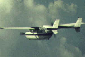

Cessna SkymasterThis is the beginning of the end. As he pulls back on the yoke, this causesthe bank angle to increase. When the bank angle increases the airspeedaccelerates even faster. By now altitude is being lost at a greater and greaterrate and he begins to pull back on the yoke with an ever increasing force.This can generate enough load to fail some portion of the aircraft structureresulting in loss of control of the aircraft and certain death.
