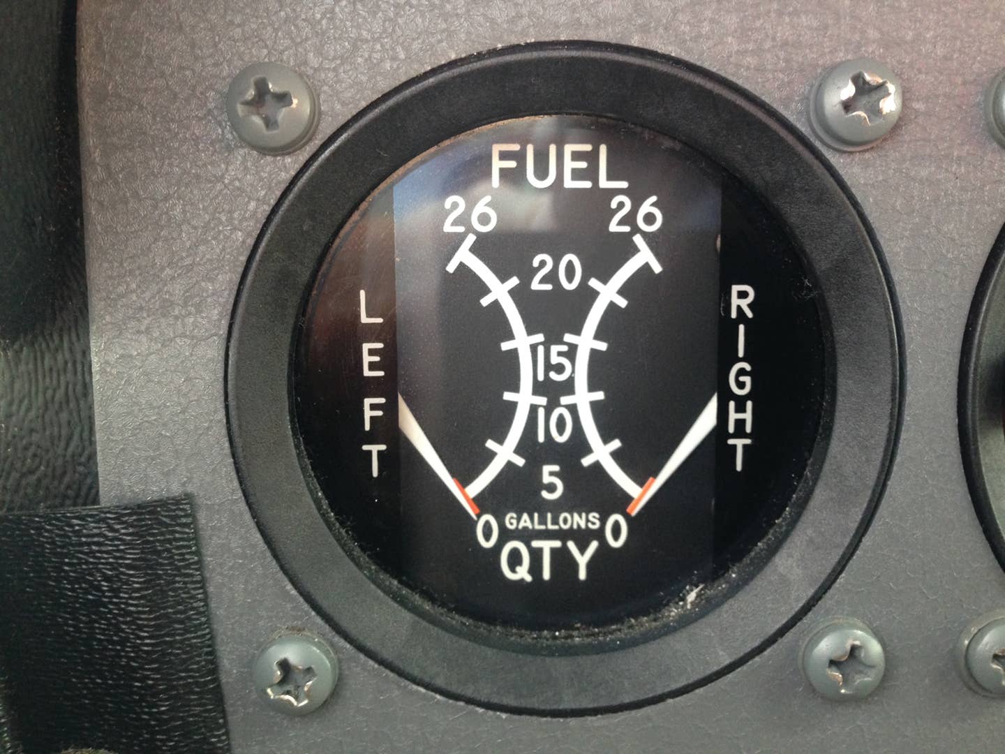

According to the NTSB’s Safety Alert, “Flying On Empty” (SA-067, August 2017), more than 50 accidents per year for 2011 through 2015 occurred due to fuel management issues. Fuel exhaustion accounted for 56 percent while fuel starvation was responsible for 35 percent. The Board has these suggestions for minimizing the risk of fuel exhaustion:
  • Know how much fuel you have onboard AT ALL TIMES.
  • During your preflight inspection, measure and/or visually confirm the fuel quantity aboard. Don’t rely exclusively on fuel gauges.
  • Know how much fuel you will need for a given flight.
  • Make sure you have a fuel reserve for each flight.
  • Know your engine’s fuel burn rate and actively monitor the fuel burn rate for the entire time the engine is operating.
  • Know your aircraft’s fuel system and how it works.
  • Review your aircraft’s POH and use the appropriate checklists.
  • Don’t stretch your available fuel supply. Stop and get gas!
