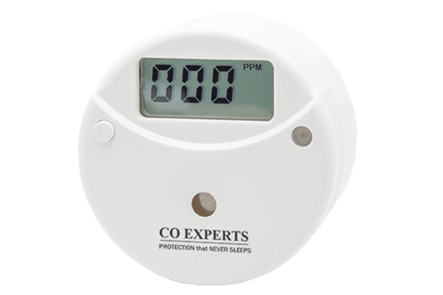

Extremely sensitive CO detectors suitable for use in personal aircraft can be purchased from the usual suppliers, and don’t require any FAA paperwork (although the FAA has developed a TSO standard for the devices). When it last looked at CO detectors, sister publication Aviation Consumer felt the CO Experts Model 2016 was the best of the units it reviewed. Since then, CO Experts has upgraded the 2016 to the PG-2017-5, which features the same low-level alerting capability and is now powered by two AAA batteries. The unit is marketed as the CO Experts Ultra by Aeromedix.com and is priced at $199.
