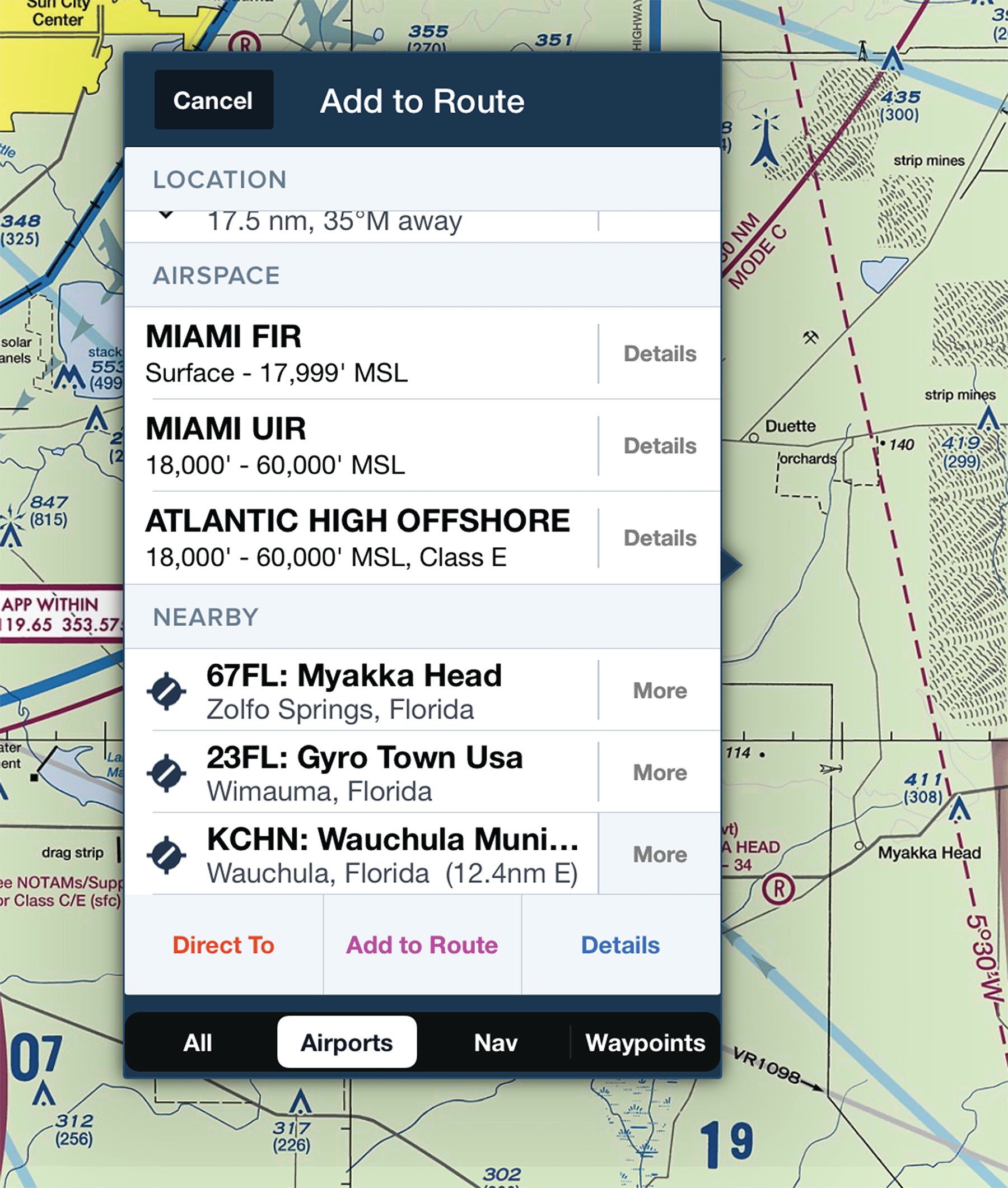

It’s always a good idea to know where the nearest airport is. If we don’t bother to keep track of every grass strip passing under our wing, the miracles of GPS and moving maps literally make it child’s play to turn over that task to the automation.
Every aviation-dedicated GPS navigator we’re aware of, whether portable or panel-mounted, has a button, often labeled “NRST,” that can bring up the nearest airport’s information and, with the push of another button, navigate to it. It’s likely the GPS navigator you use can even be configured to, for example, ignore seaplane bases and/or heliports.
The capability is even available in your electronic flight bag app, which likely can be configured to constantly display the nearest airport’s identifier, direction and distance. Otherwise, a long tap probably brings up the same information.
Bottom line? There’s no excuse for not knowing where the nearest airport is.
