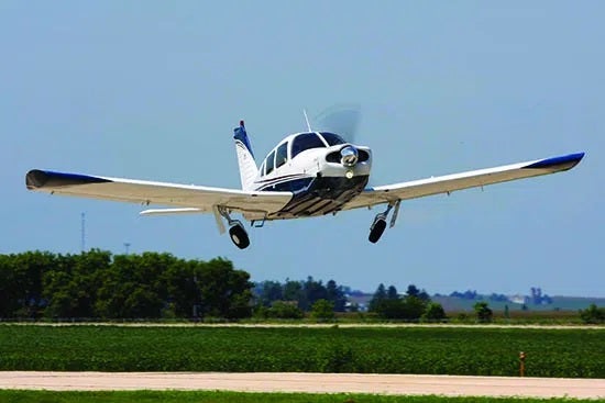

You don’t get to see the wheels come up and down from your perch in the cockpit, so it’s worth observing a gear cycle on jack stands in the shop. Image courtesy of Aviation Safety Magazine.
