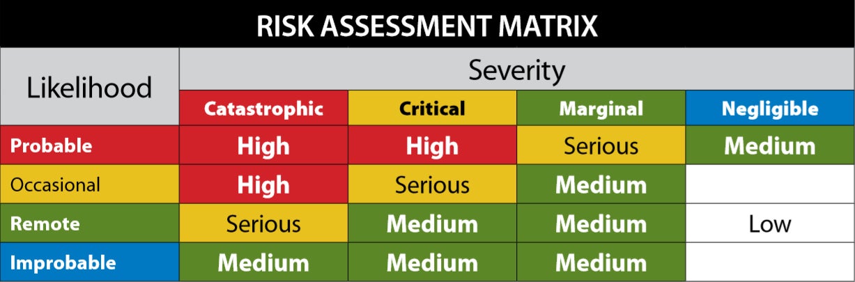

To illustrate this, let’s once again refer to the standard risk assessment matrix, below, which is used to assess risk based on the joint impact of an event’s likelihood and its severity. In the operations world, using this matrix can be somewhat subjective. When applying the “holy trinity” of risk management—identify, assess, mitigate—assessment can be the most difficult of the three functions to perform effectively. Nevertheless, training and practice can enable the average general aviation pilot to assess risk with some degree of accuracy.
In operations, the standard risk assessment matrix is used more subjectively than is ideal, while the aircraft certification process offers more objective risk evaluations and mitigations determined empirically. In any event, the goal always is to minimize either the likelihood and/or the severity of a mishap by adding features or redundancy to place potential outcomes in the green, blue or white boxes.
