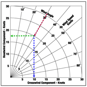

Your airplane has a demonstrated crosswind component. This number is not officially an aircraft limitation. It’s just the most crosswind encountered on the day the test pilots happened to be doing that phase of testing. It’s a good number to start with as a guide, however. The demonstrated crosswind component refers to the component of the wind that is 90 degrees to the runway. You’ll never get that figure from ATIS or the tower or Unicom operator. Figure 2 is a crosswind component chart. Your aircraft manual probably has one, too. If you are departing (or landing) on runway 28 and the wind is reported to be from 250 at 20, what is the crosswind component of that reported wind? Since the wind is 30 degrees off the nose (280-250) follow the 30-degree line down to where it intersects the 20-knot arc. Drop straight down from that to the scale on the bottom to determine the crosswind component of 10 knots and straight across to the vertical axis to determine the headwind component, which in this example is about 17.5 knots. (Notice that the sum of the components is more than the original 20 knot wind. This is common in vector math.)
Federal Aviation Regulations require that all airplanes certificated after 1962 have safe ground handling characteristics with a direct crosswind component of 0.2 Vso. If your airplane stalls at 50 knots in the landing configuration, it must have a demonstrated crosswind component of at least 10 knots. (0.2 x 50 = 10) Many airplanes do better than the minimum. The Cessna 172R Skyhawk, for example, lists a demonstrated crosswind component of 15 knots.
