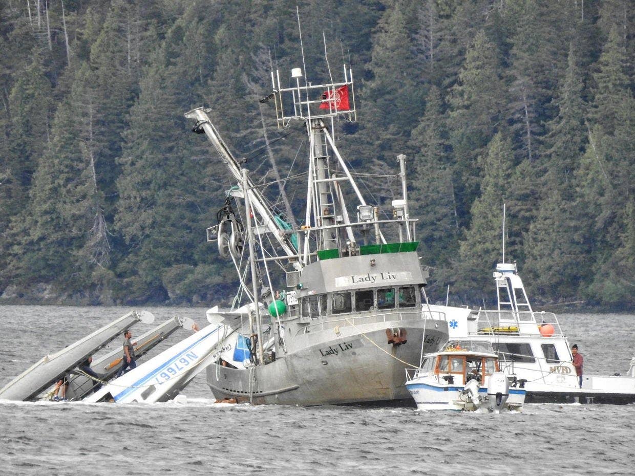

Alaskan airline and tour company Taquan Air has suspended all flying activities after a fatal crash just a week after another of its De Havilland Beaver seaplanes was involved in a midair collision on May 14 that killed a total of six people. On Monday, a Taquan Air Beaver was involved in a second fatal accident, this time in Metlakatla Harbor. Witnesses say the Beaver flipped over on landing and came to rest inverted.
Rescue crews were unable to save the passenger, identified as Sarah Luna, and the pilot, Ron Rash. The NTSB's Clint Johnson elaborated, saying, "Witnesses watched the airplane landing to the west and there was a wind, about 10 knots, and sometime during the touchdown, a float got caught. The aircraft then cartwheeled and landed inverted. It eventually came to rest upside down. The folks who saw the incident are shaken up."
