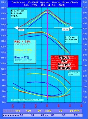

Graph (small)Here’s why. When an engineis operating on the rich side of peak, small variations in mixture don’t have much effecton power output. If some cylinders are running 75F rich of peak and others are running25F rich of peak, they’re still producing about the same horsepower and so the engineruns smoothly. Even with uneven fuel flows, most engines won’t start running rough so longas you stay on the rich side of peak.
But what happens if we move to the lean side of peak EGT? As you can see from theaccompanying graph, both horsepower and CHT starts dropping off fairly rapidly as themixture gets leaner. In fact, on the lean side of peak, horsepower varies almostproportionally with fuel flow. (As a rule of thumb, HP is equal to about 14 times GPH.Stash this tidbit away for later…we’ll come back to it.)
If you lean a “stock” Lycoming engine lean of peak, it starts running rough.Why? Because some cylinders are running richer (say 25F lean of peak) and others arerunning leaner (say 75F lean of peak), so their power outputs are noticeably different.These horsepower imbalances between cylinders are perceived as a “rough-runningengine.” But with properly flow-balanced GAMIjectors, the cylinders run atnear-identical mixtures, and put out near-identical horsepower. The net result is that youcan lean the engine well into the lean-of-peak regime without any onset of roughness.
We’re now ready for the unconventional wisdom: lean-of-peak operation. If we lean toabout 50F lean of peak, CHTs run some 25F cooler than they do at peak. The EGTs at50F lean of peak are the same as they are at 50F rich of peak, of course. Thehorsepower produced at 50F lean of peak is somewhat lower, so we compensate for that bybringing up the manifold pressure by 2 or 3 inches restore the lost power. The result isthat the engine puts out the same horsepower at lower fuel flow and cooler CHTs. Whichsounds like a good thing, doesn’t it?
