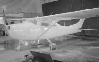

Painting an airplane-that is, the actual laying on of the color-is the quickest part of the process; a couple of good spray techs can base coat an airplane in under an hour.
But their work will only be as good as what's under the paint and that's where prep work comes in, specifically stripping, arguably the most tedious and time-consuming aspect of the job. Considering that aircraft paint has to withstand exposure to sunlight, extremes in temperature and the abrasive effects of rain in flight, it's tough stuff and equally tough to remove from aluminum.

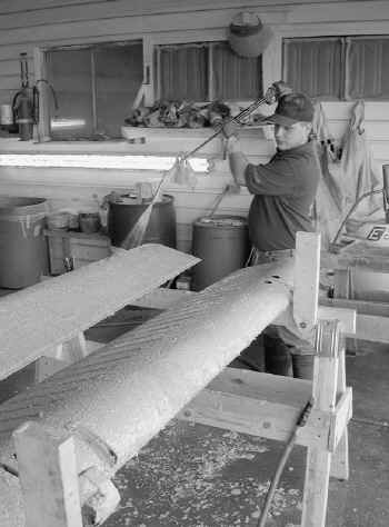

Asnoted in the sidebar, there are two methods of stripping, chemical and beadblasting. And within chemical stripping, several products are used, some benignand some not so benign. Dial Eastern uses plain industrial methylene chloridemixed with a soap or wax carrier. Although methylene chloride is consideredhazmat and requires special disposal methods, its not corrosive. Guenthertells us hes re-painted his own work on a number of aircraft in whichstripper found its way either between lapped skins or inside a structure butwasnt entirely flushed out. In that case, he says, you find a slippery, waxycoating but no corrosion.
Thats certain not to bethe case if the aircraft was stripped with acid stripper, which some shops stilluse because its faster than any other method, including blasting. However, nostripper can be entirely flushed-especially from laps-and if its notremoved, acid stripper will cause corrosion, sometimes enough to cause expensivedamage that wont be obvious for years to come.
Guenther says he has no beefwith bead blasting and believes it will produce as good a job as chemicalstripping in the hands of the right shop. On the other hand, like most shops, hecan tell war stories about blowing blasting media out of the airplane yearsafter it was stripped and painted by another shop.
