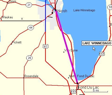

Planning A Route
MapSource does not "follow" roads in planning. As you plan your route, it will draw a straight line between the waypoints you choose. In the example at right, I chose to use U.S. 45 out of Oshkosh to Route 151 in North Fond du Lac and got a straight-line routing. Using this will work fine, though once loaded in the 295, you'll see the RMI showing you "off course." You can defeat this "problem" by selecting several waypoints along the route that follow the roads more closely. The downside to this is that the 295 will warn you as you approach each of these sub-waypoints. Personally, I prefer to live with the straight-line route and put up waypoints at route changes and specific places I want to be reminded of like planned rest stops, eateries, points of interest, etc. The 295 will dutifully show you distances and bearings to the next reminder.

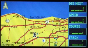

Which to use? It all depends on your mission. I was able to load the area maps for my trip from OSH to Cleveland into the 16 meg memory chip in the 295, using the Roads & Recreation database. I could only squeeze in Cleveland and Northwestern Ohio using the MetroGuide data. How much detail do you want, and how much area do you want to cover? Is your mission long trips where you'd want a lot of route detail, but don't need all the local details? R&R may be your best bet. Want to know where the nearest hotels, restaurants, gas stations, etc. are? You want the MetroGuide. Make a decision based on mission and storage, but having both databases is a viable option for those with a variety of needs, and don't mind spending the extra money. The 295 will let you de-clutter the displayed info for clarity - like using the R&R maps - so using the MetroGuide maps you can filter out details and have a "cleaner" display for long trips but you'll still pay the penalty of filling up the storage chip faster.

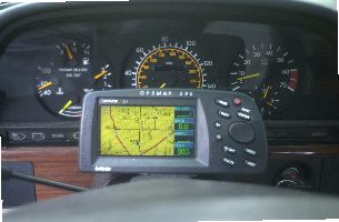

As Mike pointed out, it is indeed a little chunky, and physically a lot different from your everyday portable GPS. In the car though, this design makes more sense and works a lot better than the conventional handheld. Its more compact configuration lends itself to auto dashboards, consoles, or in my case, the steering column.
The clever and compact glareshield/dashboard mount is nice, has several adjustments available, and should work in most applications. My personal preference leans away from the semi-permanent mounting option this system affords. I'm really not fond of the idea in my application and I use this mount as a little stand to sit the 295 on my desk. Nice for when I plug it into my computer for updates, to configure the MapSource software, or just play. It's also a cute item to have on display...
In the car, I couldn't find the perfect spot to mount the 295 using the supplied mount. I was looking for the right balance of accessibility and line-of-sight. What I finally settled on was on top of the steering column, right in front of the speedometer, and flat-mounted without the stand. Using a small strip of Velcro directly on the bottom of the unit, and a larger mating piece on the steering column, I found the 295 would sit quietly, hold on during sharp turns, and mount and dismount easily. This also put it "in my scan" without covering a significant area of the car's instruments. It was also easy to reach to change pages, zoom, etc.
While trying out different locations for the mounting, I found that I could use some positions and still use the little antenna. Certainly top-of-dash lends itself to this, as do several other locations where the antenna can see the sky. Unfortunately, my location of choice hid the antenna under the top lip of the dashboard, so I need to use the external antenna. Except for the excess wire hanging down, this works very well. I stick the antenna behind the rearview mirror and it stays out of (my) sight. Yeah, this works.
One word of caution though. If you use Velcro to attach the unit in this manner, but use either the dashboard or yoke mount as well, you'll need to be careful as to where you stick the Velcro to the unit. The little cradles the mounts use fit snugly and won't fit properly over the Velcro. Placing the Velcro pieces while the 295 sits in its cradle makes this easy.

Loading the maps I wanted to use was a snap, once I got the hang of it. Using the R&R database, I attempted to load most of Wisconsin, Illinois, Northern Indiana, and Ohio into the 295. A bit too much. But with a little care in selecting the areas to load and watching the total space required, I was able to trim down the size to fit, and still cover my entire route. The 295 dutifully showed me where I was as I motored on home. It showed me the exits (even the ramps!), the highways being crossed, and all sorts of details including the next rest stop. Very cool.

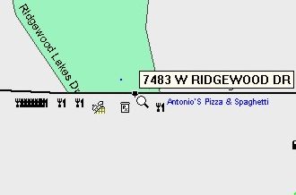

And, yes, you can find the same block info, and the same detail as shown in the MapSource program, but you can do more than that! Using the MetroGuide data, let's say you want to find someplace to get that needed pizza fix. You hear Antonio's is good, but you're not sure how far it is. Simply hit the 295's "NRST" function, select the "POI" (Points of Interest) tab, look for "Food and drink," then look for "Italian" restaurants. You'll get a list, and selecting Antonio's from the list gives a nice display of needed info. You can then enter it as a waypoint and locate it on the map display.
