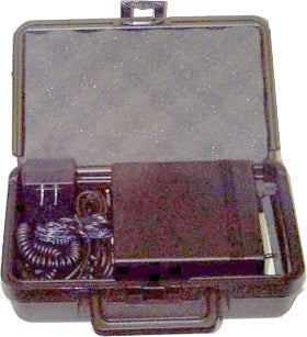

In the years following the 1991 introduction of the AirSport Pro, Phillips expanded hisproduct line to include four different AirSport models, ranging in price from $599 to$899. All four versions share a common design and operating philosophy, but thehigher-priced models have some additional features.
AirSport carrying caseThe $599 VFR model provides all basic altitude alerterfunctions and uses a backlighted LCD display, and comes complete with rechargeable batteryand wall charger. The $699 IFR model (AirSport’s biggest seller) adds an approach modethat provides DH, MDA, and check-gear-down warnings; it also comes with acigarette-lighter power cord and a very handy protective carrying case (pictured atright). The $799 IFR/VFD model is a premium unit with a gorgeous blue vacuum fluorescentdisplay instead of the LCD display. Finally, the top-of-the-line $899 Pro model addssupport for Flight Level flying, the ability to switch altimeter settings from inches tomillibars/hectopascals, and a unique “Sponder Scope” mode that displays rawtransponder output pulse trains and turns the unit into a miniature transponder/encodertest set.
All AirSport models come with a very generous 26-month warranty, plus what has to bethe best-written user’s manual I’ve ever seen for any avionics item, period.
