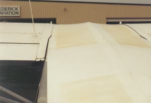

Maule with fabric discoloration due to sun exposureAbsolutely! Here is a picture that another customer sent us. This Maule is tied down in British Columbia. Dr. Gerke had used our Sunblocker Wing and Tail Covers and our wrap-around cabin cover. But you can see the discoloration of the fabric on top of the aircraft where it was not covered.
The cabin cover actually did cover a lateral area across the cabin roof, and you can see clearly in the photo how the covered area escaped sun damage. Needless to say, Dr. Gerke came back to us to cover the remainder of his plane.
It looks like there's a longitudinal strip up the centerline that isn't discolored. Was that strip covered somehow?
No, that is a peak or ridge on the top of the Maule's cabin. It has extra-thick reinforcement, plus the sun doesn't hit its sloping sides quite as directly as it does the flat horizontal surfaces on either side. That's one reason we're pretty sure that the discoloration was caused by the sun, rather than by acid rain. In British Columbia, you wouldn't suspect acid rain anyway.
