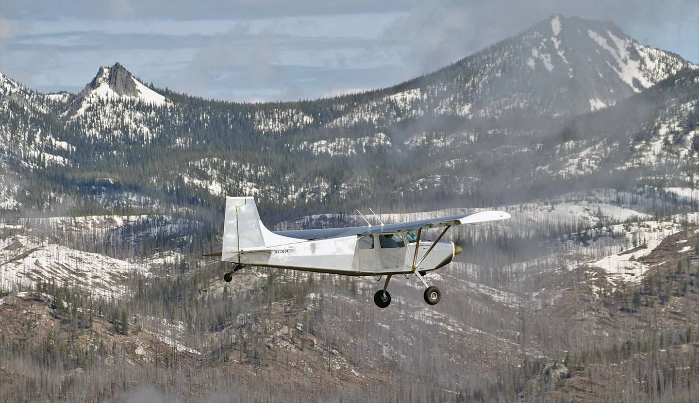

And then there is our Dream Tundra—the genesis for this article. Developed in the early 2000s in Canada, our example was the first to be purchased as part of the factory-assist program and was probably in the first five serial numbered kits to be delivered. And with that introduction, our story begins.

The Dream Tundra is a four-place, all-metal high-wing utility plane designed and marketed for backcountry pilots. The prototype was built as a floatplane, with the taildragger main gear implemented on later aircraft. Dream was based in Canada, with the principals, including the designers, drawing on the desire for a plane that could carry reasonably large loads in and out of rough locations reachable by water or backcountry strips. Aiming at the Cessna 170/180 crowd, the airplane received positive reviews in various publications, including KITPLANES® (in the March 2004 issue). Indeed, it flew well and performed as promised when it came to range and carrying capability.
But like all new designs, it had growing pains. Our particular copy was the first to be produced using the factory-assist program. The original builder (later our partner) traveled to Quebec to work with the shop personnel to build the airframe. The aluminum structure was then containerized and shipped to Nevada, where he began working on systems and firewall-forward projects. Time passed (eight years) in which not a lot of progress was made, but eventually, Dream sold in the neighborhood of 36 kits. To the best of our knowledge, approximately 15 to 18 had flown by the time ours first took to the air. We have not heard of any other completions.
