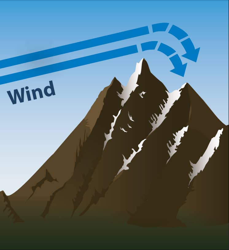

Mountain Waves
“When the wind speed is above about 25 knots and flowing perpendicular to the ridge lines, the air flow can form waves, much like water flowing over rocks in a stream bed. The waves form downwind from the ridge line and will be composed of very strong up and down drafts, plus dangerous rotor action under the crests of the waves. If enough moisture is present, lenticular clouds can form to give a visual indication of the wave action.”
Winds Aloft
“The winds aloft reports are very important to your mountain flight planning process. You should pay close attention to the forecasts at and above the mountain ridges of the terrain you will be flying into. In the west, that usually means the 9,000- and 12,000-foot forecasts. In the east, you will look at lower winds. Winds above 25 knots at these levels should be a warning sign that should cause you to think about delaying your trip.”
