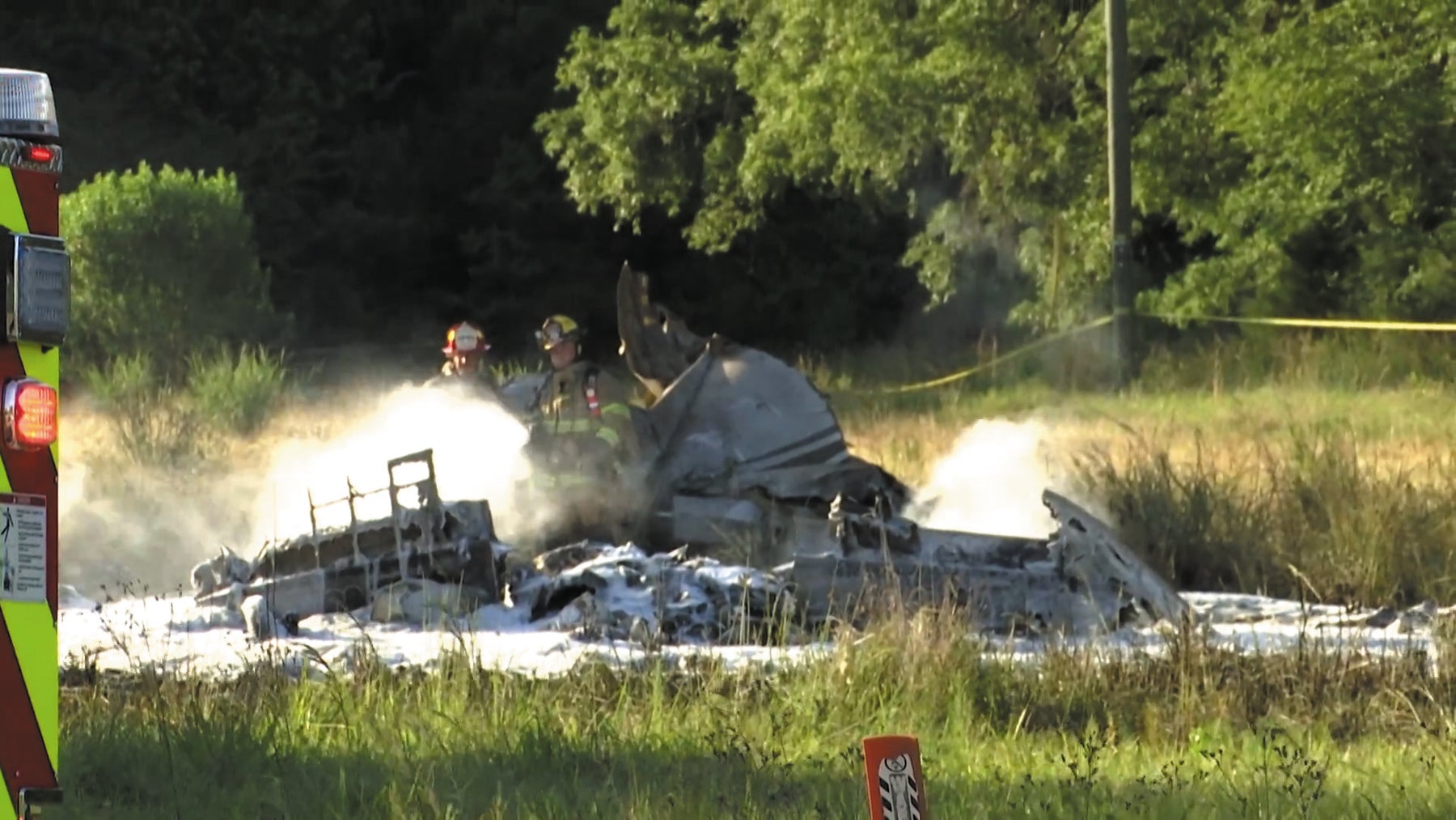

The NTSB’s preliminary report in the May 21, 2021, crash of a Piper Navajo indicates that the trim tabs were installed upside down and backward.

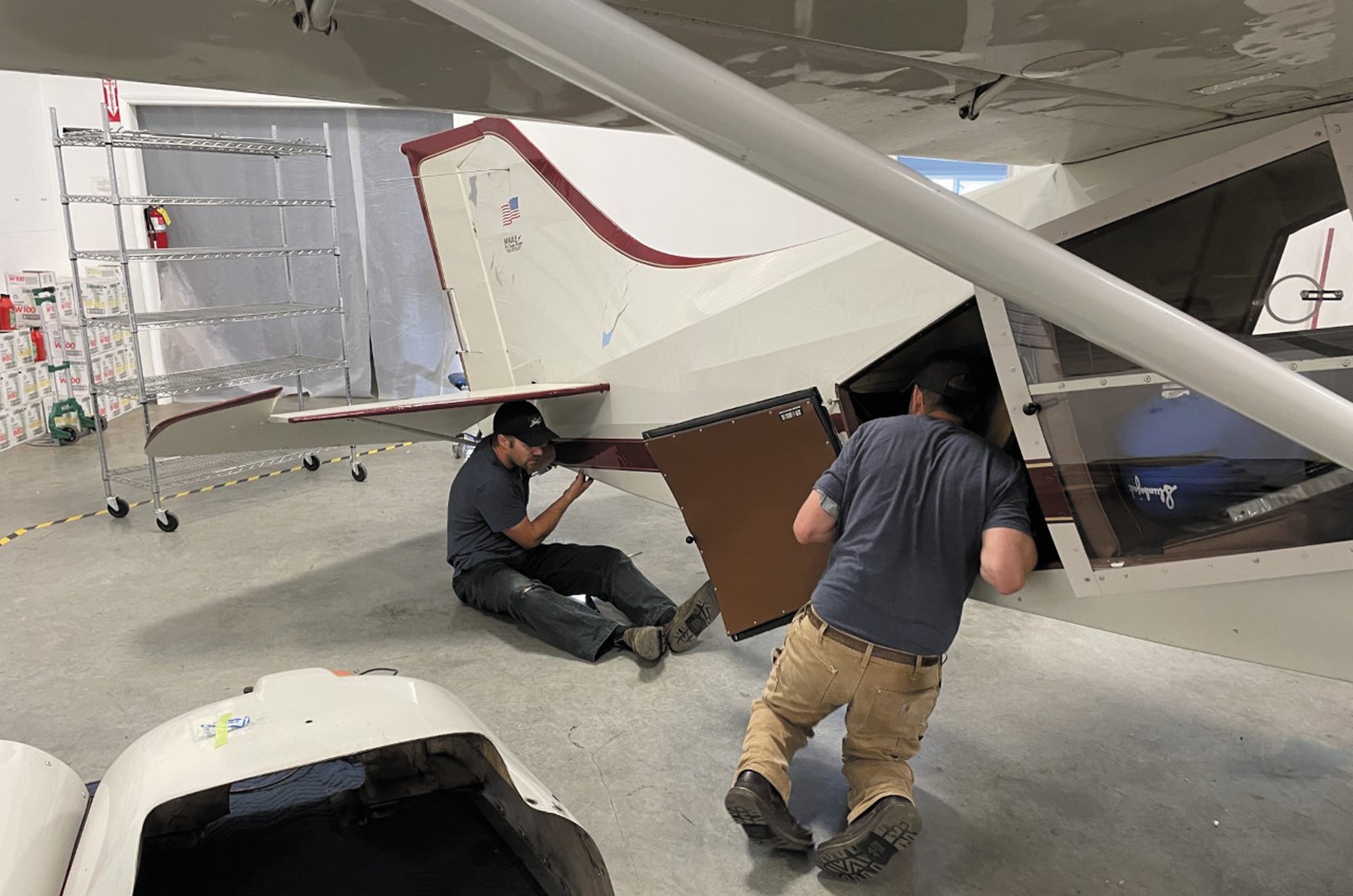

Things really do happen. During our photo session at Northern Air, Boundary County Airport, Idaho, two techs found and removed a foreign object in contact with the elevator control cables of a customer’s airplane.

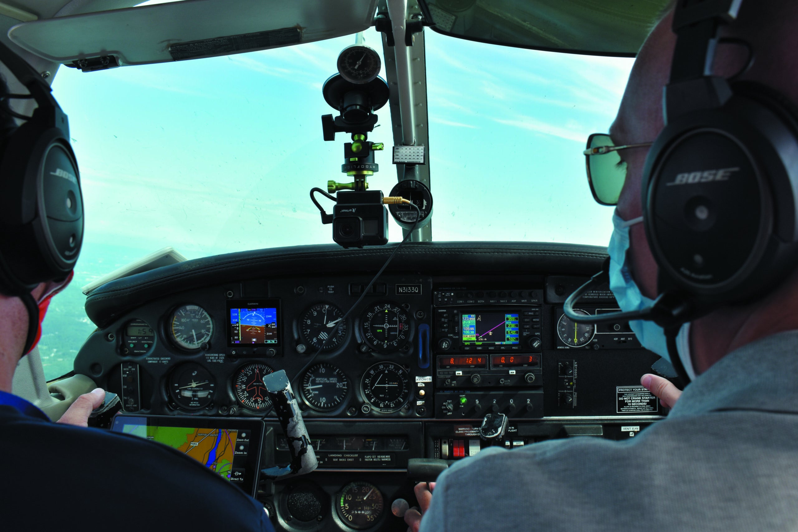

The Flight
I like the NASA launch approach for any takeoff, especially on the first flight after maintenance: The default for any decision is “No, until the airplane proves it can proceed.” For example: As I move the throttle to the full power position the question as to whether to start or continue the takeoff roll initially generates a “No” answer until the manifold pressure gauge and tach show that satisfactory power is being generated.
As pilot, you’re prepped to abort the takeoff roll if the next condition isn’t met—the airspeed needle comes alive. If it doesn’t, you abort the takeoff; if it does, you continue.
When it’s time to raise the nose and you pull back on the yoke, if the nose doesn’t come up it’s an immediate abort. If it does, continue.
If the airplane doesn’t lift off and start to climb and accelerate normally, abort the takeoff and land on the remaining runway.
Climb at VY for the first 1000 feet to get as much air under the airplane as quickly as possible while being alert for any indication that all is not well. Continue the climb to the initial altitude you’ve selected while maneuvering to stay within gliding distance of the airport.
Level off and follow the cruise checklist, setting power at the level you’ve planned (high if it’s an engine or cylinder break-in), leaning the mixture appropriately and setting trim and cowl flaps. Don’t stop looking outside for traffic, as you check all engine indications and check control responses and work your way through the checklist you’ve created to ensure all is well with the engine and airframe.
Then give yourself a little time to just fly the airplane at different speeds and power settings and check that CHTs stay at appropriate levels. Cycle the gear and flaps. Check the avionics again to make certain everything is working. Write down any squawks.
