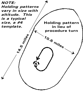

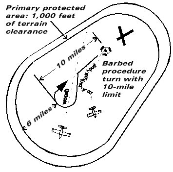

The drawings at right depict the typical protected areas for both a standard,barbed-procedure turn and for a holding-pattern-in-lieu of a procedureturn. As you can see, there’s plenty of safe maneuvering room around bothtypes…unless you happen to be flying a very fast airplane, fast beingup to the 250-knot-below-10,000 feet-MSL limit. That’s not to say there’snot enough room for a fast mover — say a biz jet — to make the coursereversal, it’s just that there’s less margin if you get careless.
On Jepp charts, the procedure turn barb is to scale in the plan view.That means if the profile view says "10 NM from NDB," the outeredge of the barb is at the 10-mile limit. If the PT limit is only fivemiles — as it is if the approach is limited to Cat A airplanes — thebarb is obviously much shorter. On NOS charts, the plan view has a 10-miledistance circle and virtually all of the barbed PTs extend to the insideedge of this circle. On both charting systems, the holding-pattern-in-lieuof PT reflects no particular scale; it’s just a graphic representation.The obstacle clearance area we’ve drawn here represents a typical applicationfor a holding-pattern-in-lieu of: the number 4 holding pattern template.
The thing to worry about here is approaching the PT fix at a relativelyhigh airspeed and perhaps with a stiff tailwind. In a 100-knot Cherokee,unless you’re asleep at the yoke, you’ll probably have plenty of time toget yourself turned around without busting even the relatively small protectedarea of a holding pattern-in-lieu of PT. But if you’re driving a Lear intothe very same airport, the protected area is the same size as it is forthe Cherokee.
You could be doing 300 knots over the ground; five miles a minute. At100-knots, the turn radius of the Cherokee is about 1/4-mile. For the Lear,it could be more than a mile-and-a-half, even without taking into accountthe tailwind, which could push the turn toward the edge of the protectedarea.
