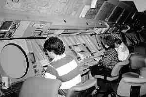

The failure occurred, at 7:13 a.m. local time during the morning"departure push" period. Controllers estimate that 60to 80 aircraft were under ZOA control when the power died. Allradar screens went dark and all radio communications were cutoff. Lights and telephones were unaffected. It took 45 minutesto restore radio and the backup DARC (direct access radar channel)radar system and more than an hour before the NAS computerizedradar was restored.

Controllers were stunned as their screens went dark, their headsetssilent, and the perpetual whirr of equipment cooling fans ceased.Once controller described it as "the loudest silence I'dever heard."
Another controller told AVweb that there was "panicon everyone's face" as the controllers realized that theyhad been rendered deaf, dumb, and blind.
"We don't train for a situation like this," the controllersaid.
It took a minute or two for controllers to realize that the failurewas facility-wide. Most turned to their supervisors for guidance,and the supes turned to their supes. But there's no book procedurefor handling a situation like this. So in the end, most controllerswound up improvising.
