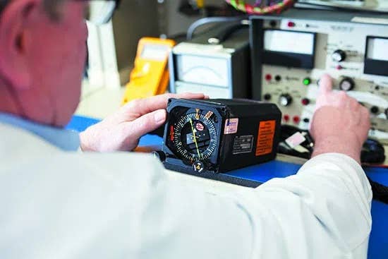

An instrument bench tech in the gyro lab at Mid-Continent Instruments and Avionics puts a Century NSD360A HSI to the test. A quality overhaul for these vacuum-driven instruments could run well north of $2500 after removal and installation.
