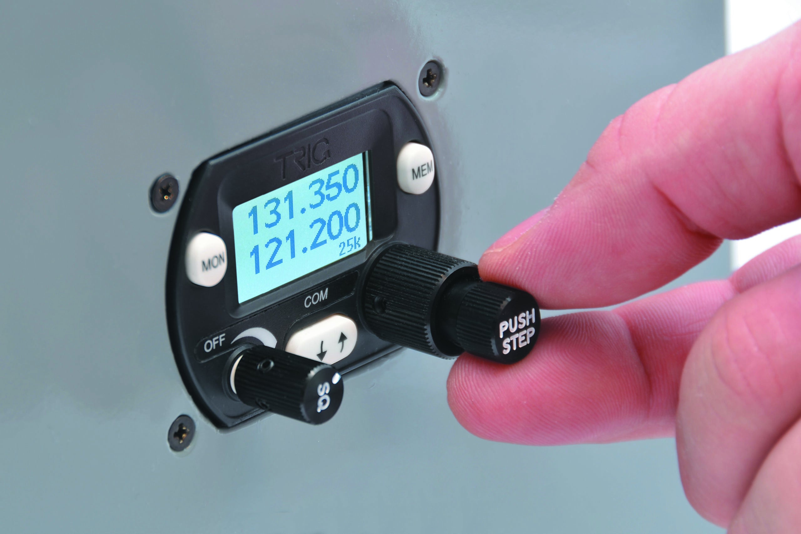

If you are out of room in the main radio stack, there are several good options for mounting a radio either on the instrument panel or in an instrument cutout. Pictured here is a Trig space-saving VHF control head.

Trig Avionics
Another manufacturer that puts a sharp focus on saving panel space is Scotland-based Trig Avionics, offering the Compact and Stack lines of VHF radios. The radio-stack-mounted models are the $1865 TY96A (10- watt transmitter) and $3048 TY97A (16-watt transmitter—which only works in 28-volt electrical systems). The radios stand 1.3 inches tall in a standard 6.3-inch-wide radio stack, require 10.63 inches of panel depth and weigh 2.09 pounds. No forced air cooling is required, says Trig.
The “A” suffix Trig radios have basic 25 kHz channeling (the straight TY97 and 96 have both 25 kHz and 8.33 kHz channeling). All models come standard with a two-place stereo intercom and aux input for entertainment and warning systems.
The Trig radios can integrate with compatible GPS navigators using the Garmin SL-40 and GTR 225 data protocol to automatically display frequencies along a route, based on GPS position. As noted earlier, this is a serial data connection between the radio and the navigator.
The Trig radios also have a dedicated Mon bezel key for monitoring the audio of the standby frequency (something Trig calls Dual Watch), an Emer key for quick tuning the 121.500 emergency frequency and a Play button for playing back 30 seconds of the previous receiver audio. Trig calls this the “Say Again” feature, and it’s a welcomed addition to an already generously equipped radio.
For instance, the rig comes with a USB memory stick for building a customizable frequency database for loading (up to 200 channels and their associated facility names) into the radio as CSV files. The USB port is on the lower left front of the radio’s bezel, and there’s a dedicated Mem key for accessing the frequencies.
The remote versions are the $1110 6-watt TY91 (for 14-volt electrical systems) and $2943 16- watt TY92 (for 28-volt systems). The remote transceiver has most of the features of the rack-mounted version including two-place stereo intercom, Dual Watch and a nine-frequency memory bank.
You’ll have to find someplace to mount the transceiver, which shouldn’t be a big deal—it measures 1.88 by 2.59 by 6.29 inches. That’s reasonably compact. The control head for channeling it measures 1.73 by 2.48 by 1.37 inches, fitting a 2 ¼-inch instrument cutout.
Trig offers prefab wiring harnesses for the TY91 and TY92. Each harness includes connections for the radio and control head, and the company offers both long (118 inches) and short (39 inches) harnesses. The D-Sub connector-equipped shielded harnesses come with mic and phone audio jacks attached, and the installer provides the circuit breaker or fuse protection.
Worth noting is that PS Engineering uses the Trig remote radio as part of its PAR200 audio panel/ VHF radio combination. The ones we’ve installed and used have been good performers. Contact www.trig-avionics.com and www.ps-engineering.com.
