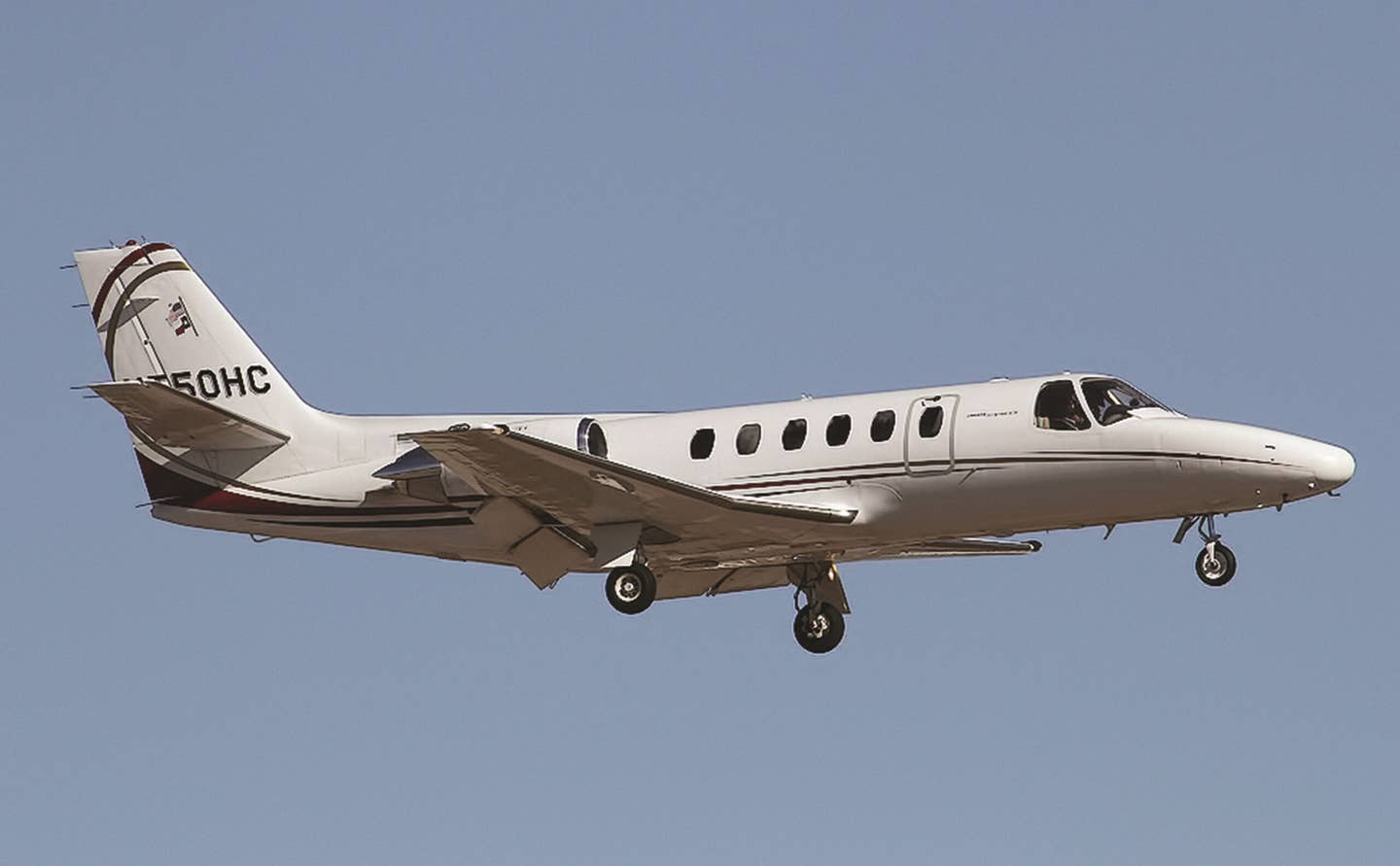

On May 22, 2019, at about 1245 Eastern time, a Cessna Citation S550 SII was destroyed when its pilot lost control shortly after takeoff near Greenfield, Indiana. The pilot (male, 75) and passenger were fatally injured. Visual conditions prevailed; an IFR flight plan had been filed.
A witness on the ground later reported seeing the airplane turn shortly after takeoff from Runway 07. It was in an estimated 90-degree left bank with the wings vertical and the fuselage parallel to the ground. The nose lowered slightly before rising to a level attitude. The wings started to level, then the nose went straight down, and the airplane disappeared behind trees. The airplane impacted a field about ½-mile northeast of the departure airport.
Commercial flight-tracking data show the airplane climbed through 1025 feet MSL (163 feet AGL) as its groundspeed began decreasing from its maximum of 141 knots at takeoff. As the jet continued to climb and turned north, its groundspeed continued to decrease until the last recorded data point, at about 1125 feet MSL (263 feet AGL) and a heading of 346 degrees, with a groundspeed of 100 knots.
Surface wind reported about 10 minutes earlier was from 170 degrees at nine knots, gusting to 14. When applied to the 100-knot groundspeed and heading, the Citation’s airspeed was estimated as between 86 knots and 93 knots.
Investigation
The airplane impacted a flooded cornfield and was significantly fragmented, leaving a wreckage field about 270 feet long and 103 feet wide. Both engines had separated from the airframe. A post-impact fire consumed about 80 percent of the airplane. Examination revealed no signs of preimpact mechanical malfunctions or failures. Both engines displayed circumferential rub marks on all rotating stages and debris ingestion. Both engine FADECs were recovered. The left engine FADEC’s nonvolatile memory could not be downloaded but the right engine’s had not recorded any faults.
The airplane was originally certificated for two pilots. The pilot held type ratings for the Cessna CE-500 and CE-525-S, and Beechcraft RA-390-S airplanes, and he had obtained a single-pilot exemption for the Citation S550 SII.
A pilot who had flown in the Citation with the pilot/owner the day before the accident later stated he had concerns about the pilot’s abilities. During takeoff and once airborne, when the airplane was between about 105 and 110 knots, the accident pilot began reducing power when the airplane was “not very high off the ground” and continued to fly at slower speeds, between about 140 and 150 knots. He said the accident pilot told him that the jet “flew like a 172.” He added that every time he had flown with the accident pilot, he was “very behind the airplane.”
The airplane’s performance and stall speeds were calculated based on its empty weight, the pilot’s and passenger’s weights, full fuel, 20 degrees of flaps and the ambient conditions. Its calculated rotation speed would have been 95 KIAS, and its best climb-rate speed would have been 195 KIAS. The engine manufacturer-recommended cruise-climb speed was 224 KIAS. With a 45-degree bank angle, stall speed was calculated to be 100 KIAS and 118 KIAS at a 60-degree bank.
Probable Cause
The NTSB determined the probable cause(s) of this accident to include: “The pilot’s failure to fully advance the power levers during the takeoff and initial climb, which led to his failure to maintain sufficient airspeed and resulted in the exceedance of the airplane’s critical angle of attack and a subsequent aerodynamic stall.”
According to the NTSB, the Citation’s Airplane Flight Manual stated that the pilot must, in part, “advance the throttle lever to the maximum takeoff detent for the FADEC’s nonvolatile memory to record a logic trend snapshot two seconds after takeoff.” Such a datapoint was missing from the retrieved FADEC data, which the NTSB said “is consistent with the pilot not fully advancing the throttles during the takeoff and initial climb and is likely why he did not attain or maintain sufficient airspeed.”

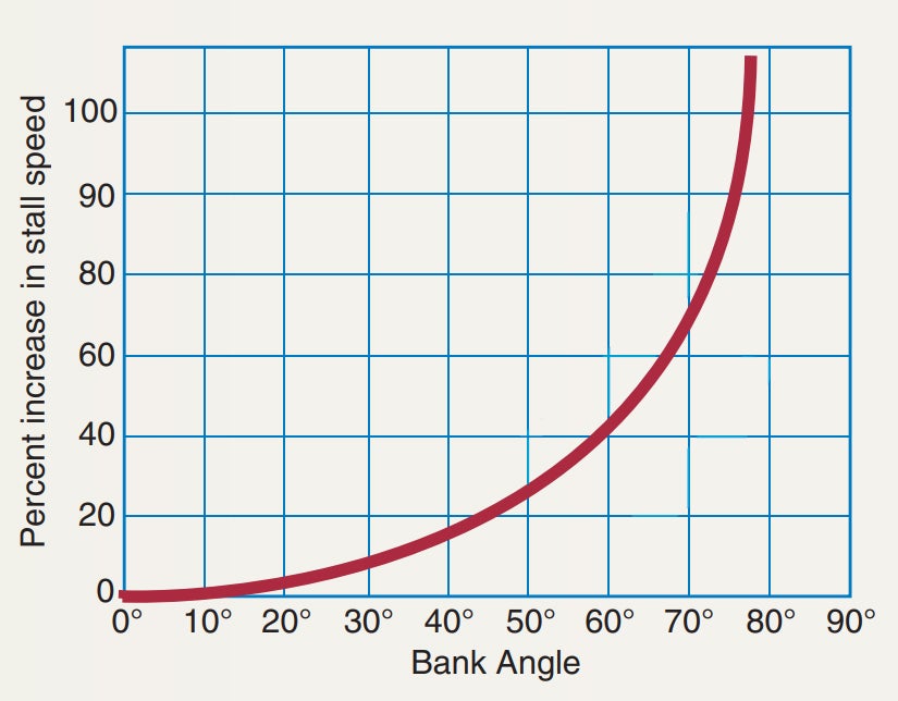

Bank Angle Vs. Stalling Speed Vs. Load Factor
At first, pilots are taught to respect the published stall speed. Then they’re taught that speed has little to do with when and how a wing stalls, and that angle of attack is what we should pay attention to. Soon, we’re told about load factor and how it increases in a level, banked turn. Finally, we’re also admonished that increasing the load factor also increases the stalling speed, perhaps with a graphic like the one at right to explain the relationship.
It should be hard to ignore that an airplane can stall at any airspeed, bank angle or load factor if we neglect one of these other two elements, but pilots regularly demonstrate that forgetting some of the physics keeping us in the air actually is relatively easy to do.
When we’re determined to do things differently, technology like angle of attack indicators or the various flight instruments—along with stall warnings as a last resort—can’t prevent us from ignoring these rules of basic airmanship.
