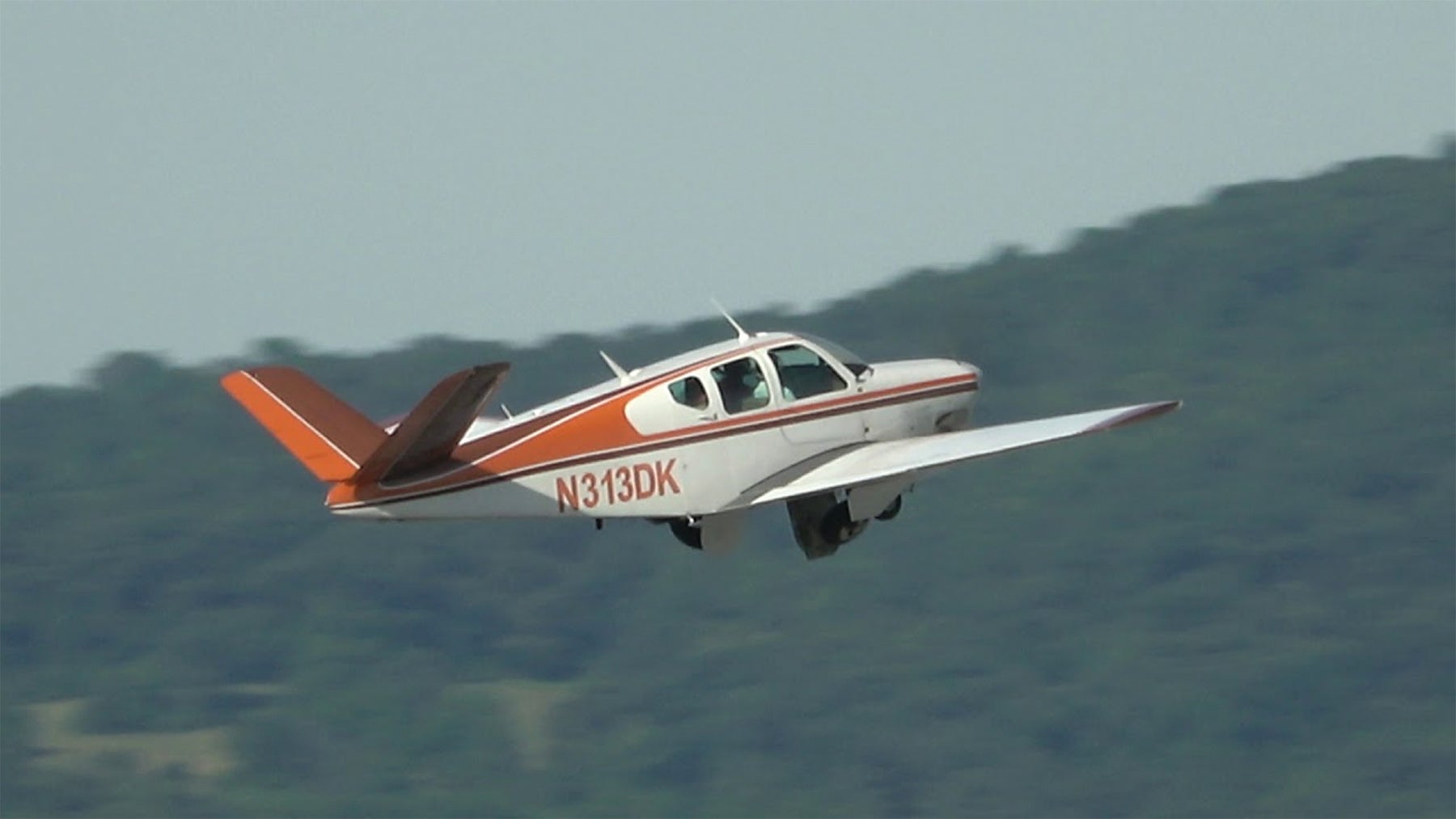

Aircraft Profile: Beechcraft G35 Bonanza
OEM Engine: Continental E-225-8
Empty Weight: 1722 lbs.
Maximum Gross Takeoff Weight: 2775 lbs.
Typical Cruise Speed: 160 KTAS
Standard Fuel Capacity: 39 gallons
Service Ceiling: 19,000 feet
Range: 550 NM
VS0: 48 KIAS
