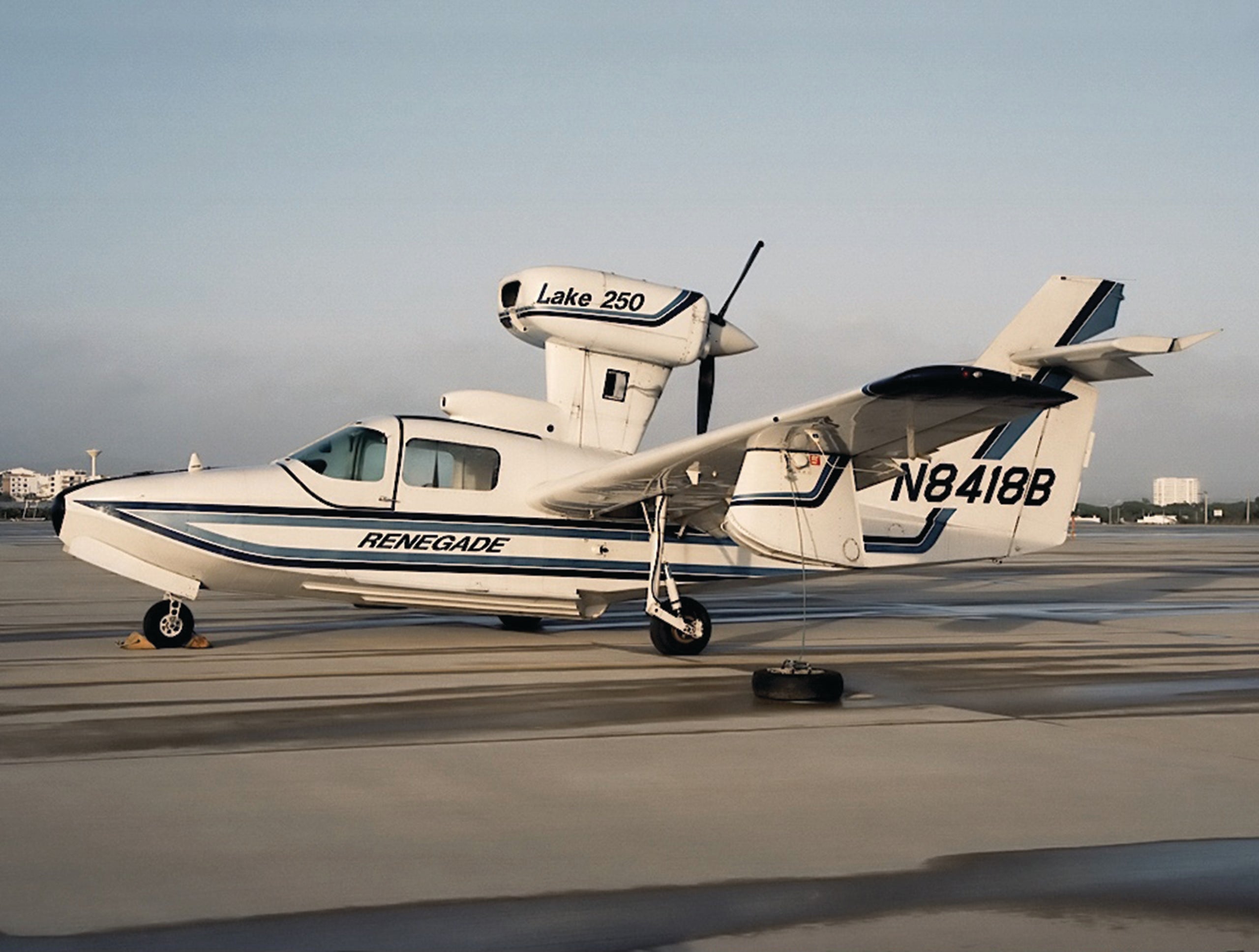

On July 27, 2017, at 1943 Central time, a Lake LA-4-250 amphibian was substantially damaged when it impacted Lake Winnebago during takeoff from the Vette/Blust Seaplane Base in Oshkosh, Wisconsin, during that year’s EAA AirVenture Fly-in. The airline transport pilot and one passenger were fatally injured; the pilot-rated passenger received minor injuries. Visual conditions prevailed.

Aircraft Profile: Lake LA-4-250 Renegade
OEM Engine: Lycoming IO-540-C4B5
Empty Weight: 1850 lbs.
Maximum Gross Takeoff Weight: 3140 lbs.
Typical Cruise Speed: 122 KTAS
Standard Fuel Capacity: 85 gal.
Service Ceiling: 12,500 feet
Range: 1000 NM
VS0: 53 KIAS
