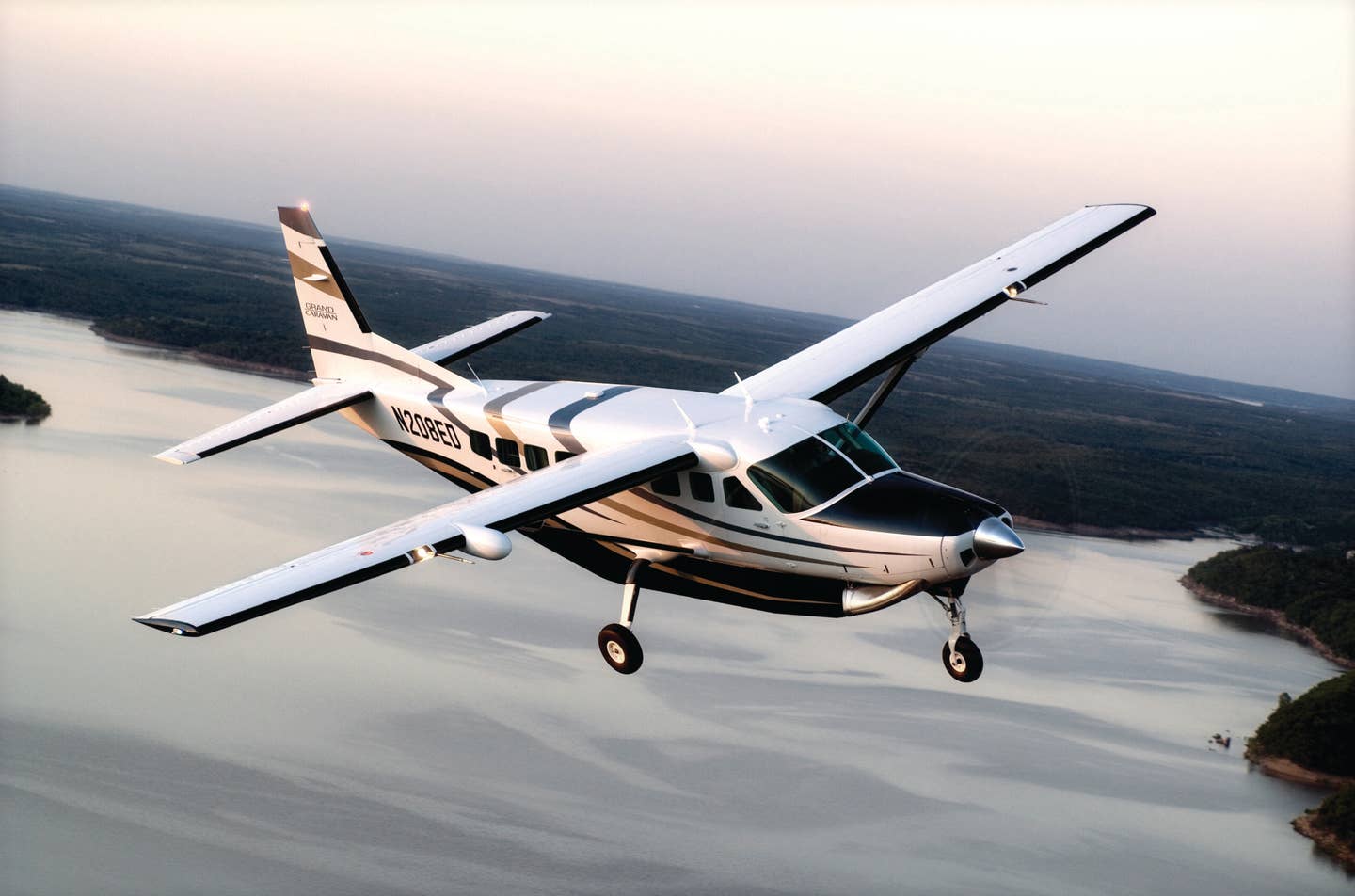

Not accident aircraft.

Aircraft Profile: Cessna 208B Grand Caravan
OEM Engine: P&WC PT6A-114A
Empty Weight: 4550 lbs.
Maximum Gross Takeoff Weight: 8750 lbs.
Typical Cruise Speed: 170 KTAS
Standard Fuel Capacity: 332 gal.
Service Ceiling: 21,900 feet
Range: 789 NM
VS0: 61 KCAS
