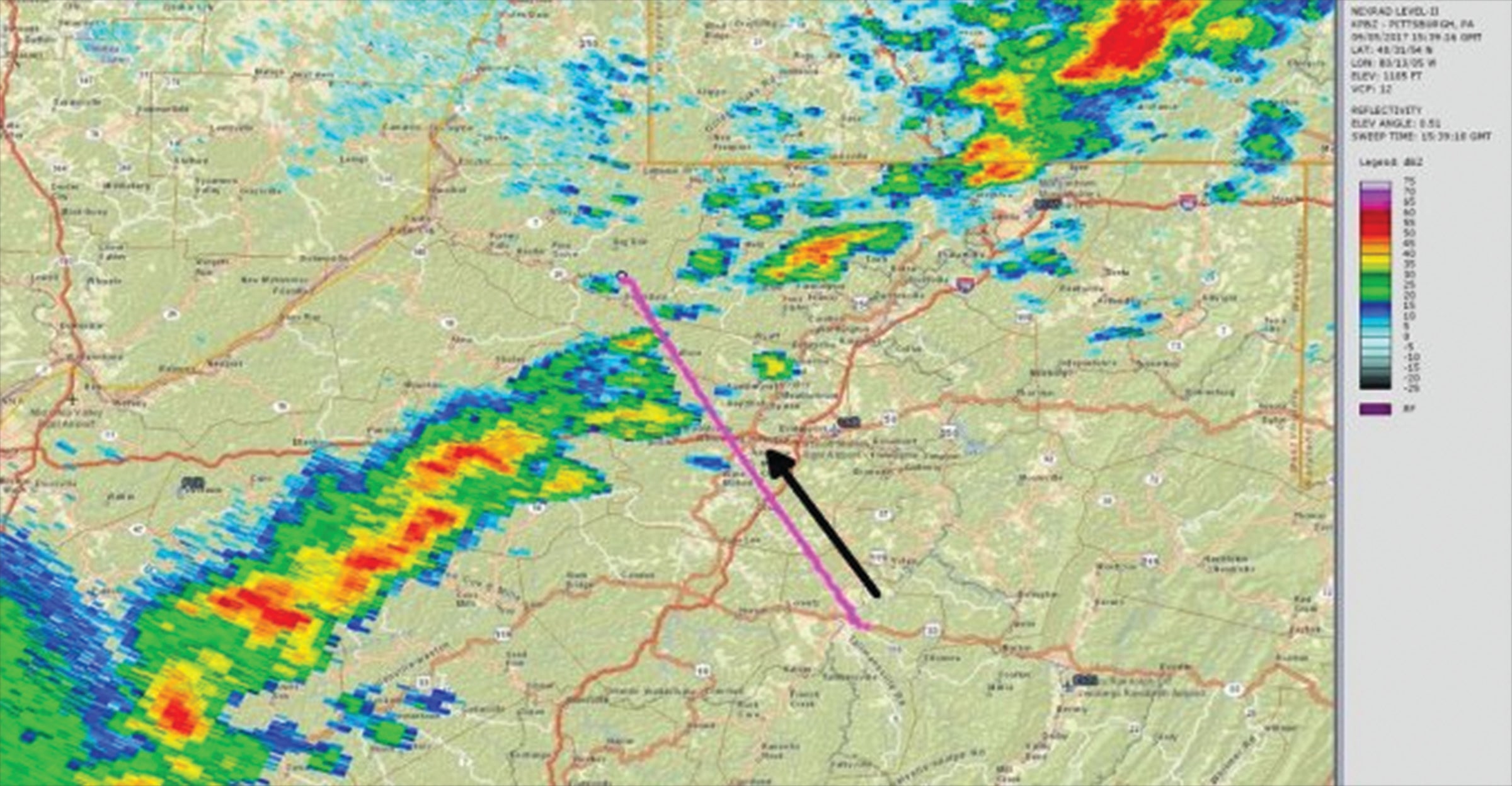

The image in the sidebar, “Frontal Activity,” below is from the NTSB report on this accident. It depicts the weather’s reflectivity for the 0.5-degree elevation scan initiated at 1139, nine minutes before the crash. The airplane’s flight track, as recorded by FAA radar, is shown by the pink line, with the black arrow indicating the direction of travel.

The radar image below shows the pilot aiming his airplane for a gap in the line of thunderstorms. Other radar images in the NTSB’s file for this accident show the gap slowly closing over the hour preceding the accident. According to the images, the SR20 had already passed through the gap and was on the back side of the storms when the pilot lost control.
At that point, he should have been home free. But apparently the pilot encountered additional turbulence, outside the heavy precipitation depicted on radar. Keeping in mind that radar doesn’t depict turbulence and that in-cockpit Nexrad radar imagery easily can be 20 minutes old by the time it’s displayed, something else was waiting on the back side of the gap. Landing and waiting it out would have been a better choice.
