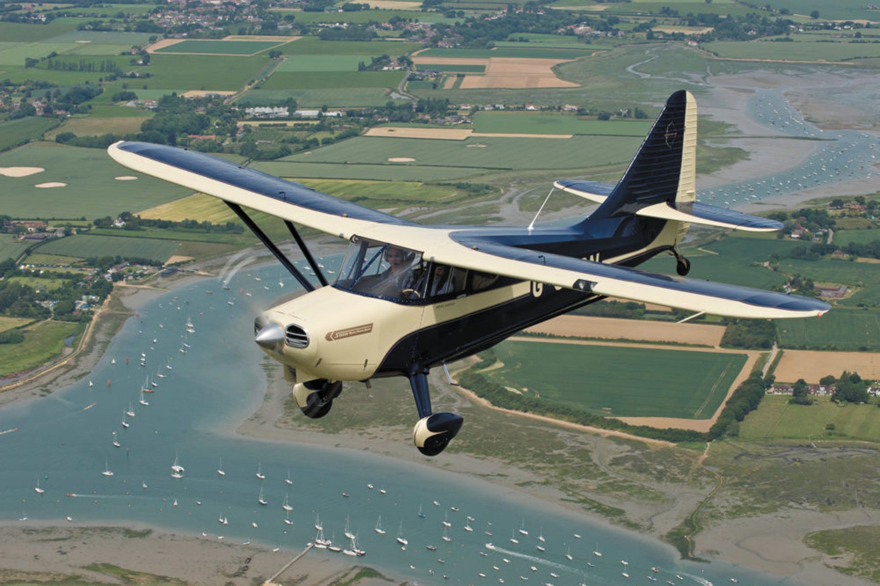

Anticipating the post-war aviation boom, Stinson created the Model 108 and equipped it with a 150-HP Franklin engine. Widely regarded for good handling and decent performance, more than 5000 were built.
We spent time with a pilot who had owned a 108 for over 30 years, but was unwilling to be identified. The first recommendation we heard was to join the owner’s association (www.facebook.com/groups/20082572978/) and then find an A&P with experience with Franklin engines and Stinsons. That’s important because Franklin engines need some specific tools. As a test, an A&P should be able to pull the forward spark plugs without taking off the nosebowl.
We were advised that anyone looking for a 108 should make sure that the Franklin engine has an oil filter—it’s the best thing that can be done for the engine. Without an oil filter our owner told us that it’s a 600-hour engine. With an oil filter it should last as long as a Continental or Lycoming.
A prebuy exam should include looking to see that the airframe is true and looking under the floorboards for repairs due to a groundloop. The base of the aft door frame is a corrosion point; check it carefully. Check the rudder rib at the base of the counterbalance for cracking.
As for brakes, Goodyears are bad, Bodell brakes are okay and Clevelands are good, but be careful—they are so good that you can put the airplane onto its nose.

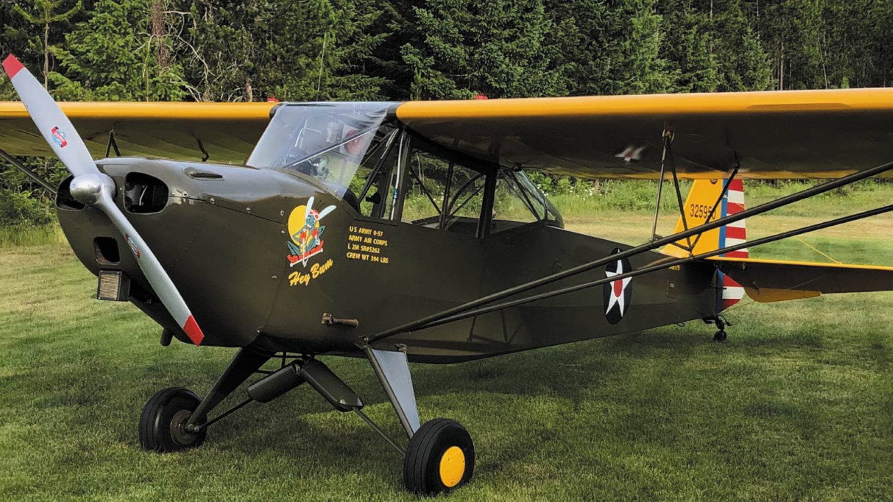

In response to U.S. Army interest, Taylorcraft turned its Cub into an observation platform by creating what amounted to a bubble canopy—and it became the L-2 Grasshopper. For those considering a purchase, areas of concern are the same as its tube-and-fabric competitors: fabric age and condition, corrosion and quality of repairs after a groundloop.
We did get comments indicating that availability of parts for the small Continental engines are beginning to become an issue.
L-2 owner Oscar Campbell knew the L-2 he intended to buy. It had served in the Army Air Force within the U.S. and was sold as surplus following the war. It spent some time as a display in a museum, before being sold because the museum needed the money.
The L-2 changed hands a few times before the owner worked with his local EAA chapter, where it underwent a 15-year-long restoration. It then flew only sporadically before Campbell’s careful prebuy exam and purchase.
Campbell and an A&P friend picked up the airplane in Northern California and began the ferry flight to its new home in North Idaho. It took three weeks. The first issue was a trim failure. Repairs were easy, but reflected the problem of an aircraft restoration by the committee system. The folks working on the L-2 had forgotten to install cotter keys on the castellated nuts on the trim system and they vibrated off.
At the next stop, one of the ancient Eisemann magnetos failed. It had eleven hours total time. Campbell made the decision to install the kit converting the engine to Slick magnetos. Getting parts and making the change consumed a few days.
Taxiing out after fueling at the next stop, the left wing began to drop as the left main gear slowly collapsed. The problem? The calendar age of the rubber landing gear bungees. One had simply come to the end of its life and broke.
Campbell told us that he knew what he was getting into and was aware that he was going to have some problems because the airplane had not been flying. He went into it with his eyes open, patience and a healthy proportion of his budget set aside for repairs.

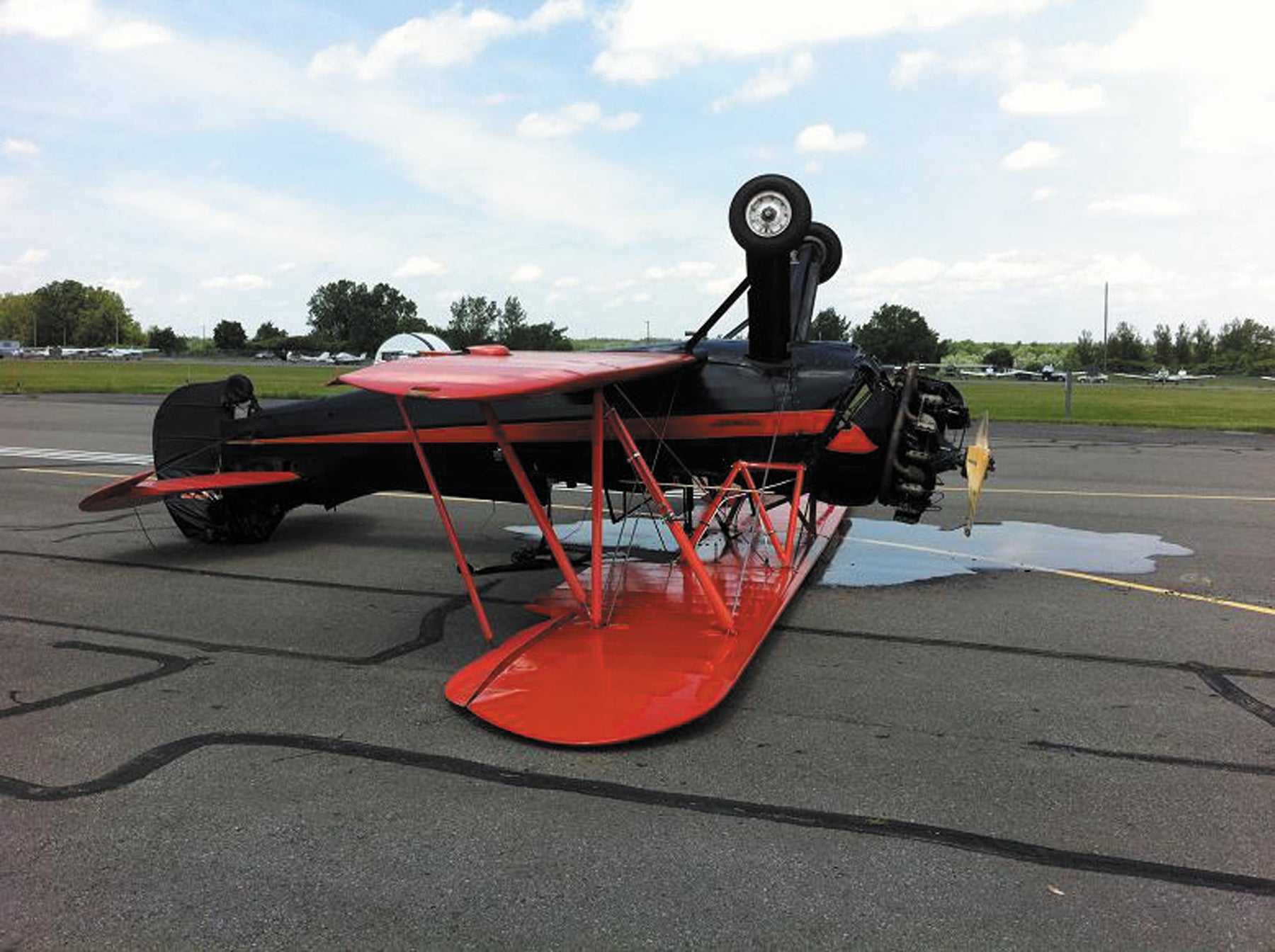

Four years after Lloyd Stearman sold his company to Boeing and took a job as president of Lockheed, what became the Model 75 Kaydet was hatched for the U.S. Army and Navy as a primary trainer—and forever after, everyone called it the Stearman. Over 8500 of the incredibly strong (10 G plus and minus) biplanes were built and, after being sold as surplus after the war, proved to be amenable to anything from cropdusting to airshow work.
Because there are flights schools offering dual in Stearmans to this day, we consider it (or a new production Waco or Great Lakes) to be the stepping stone for anyone wishing to buy a biplane.
Because of the many mods available to the Stearman line, a careful check of the logbooks is vital. Was the airplane converted to be a cropduster and then back to a two-holer? How were the conversions done? Is the airframe true?
The airframe is tough, but not invulnerable. Look it over carefully. Putting the airplane onto a wingtip during an incipient groudloop is likely to break the rear spar.
Most of the stock airplanes had 220-HP Continentals or 225-HP Lycomings. There have been crankshaft issues, especially with radial engines that were built for tanks (the heavy things with treads and big guns) but later hung on Stearmans instead.
The stock airplanes barely have enough power to get out of their own way. 300- and 450-HP mods proved popular; however, no two seem to be the same. Expertise on a prebuy of a big-engine Stearman can prevent an expensive purchase mistake.

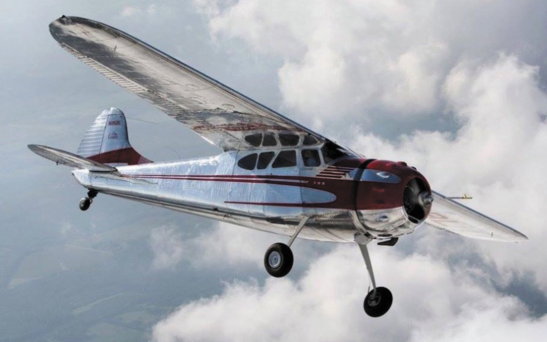

Cessna’s five-place, tailwheel radial-powered singles had Continental or Jacobs engines ranging in power from 240 to 300 HP. More than 1000 were built (including the LC126 military version).
The series has a high rate of loss of control accidents on landing. We believe that one reason is because of misalignment of the landing gear— something that takes some expertise to get right. Failure to properly maintain the tailwheel strut also leads to ground-handling issues.
We also consider the sight picture on landing to be a little unusual, causing new pilots to point the airplane at an angle to the runway when they think it’s straight. This, tied in with gear alignment issues and the runway loss of control history require, in our opinion, an extensive checkout in the airplane by a CFI who knows 195s. A pilot should be equally comfortable with three-point and wheel landings.
Owners tell us that the original Goodyear brakes are satisfactory if they are carefully maintained. A popular mod is to replace them with the brakes from a Cessna 310.
