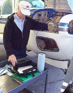

The Prebuy Inspection
It is absolutely, positively essential that you have a prepurchase inspection done by a mechanic or shop that you respect. Never, ever, ever, ever let the seller select who will do the prepurchase inspection. If you need to locate a reputable mechanic at a remote location one of the best ways is on the Internet on one of the better aviation forums such as AVsig on CompuServe. Putting up an inquiry usually results in some good ideas that will at least give you some guidance as to whom to call.
Be patient. A good prepurchase inspection is going to take a very full day on a simple single-engine airplane, and longer for a complex one or a twin. That's okay, because if it passes the prepurchase inspection and you buy the airplane you are going to go ahead and complete an annual inspection on the airplane anyway.
Go into the prepurchase inspection as if you are trying to find a reason to disqualify the airplane. That is the safer mindset than if you are trying to find reasons to qualify the airplane. You may like the looks so much that you use them to qualify and accept an otherwise questionable mount.
The first step in any prepurchase inspection is a detailed examination of all the logbooks. They must show compliance with every single AD (or the reason each one does not apply) or someone is going to have to pay for compliance for any that the records show weren't done before you agree to accept the airplane. You may find that it's a minor matter, or it may be a big deal. Lack of AD compliance is a good way to kill a sale very quickly. Going forward with a purchase where there is question regarding AD compliance is not one of the smartest things you will do in your life.
For reasons I have never understood, aircraft and engine logbooks usually do not have page numbers. Look at each page carefully to see if any have been razored out. Read each and every entry. This is detective time. Did the airplane sit dormant for a couple of years? That's a hint that there may be corrosion in the airframe or in the engine. Was it getting 100-hour inspections every few weeks? If so, it was probably a trainer, so look over the areas that students beat up. Your mechanic should be the person to take the lead in the logbook examination as he or she is more likely to know what to look for than you; however, you should be heavily involved as two people casting jaundiced eyes on entries are less likely to miss something than one person.
When was the last time the airplane was weighed? If more than about five years ago, figure that you will need to have it weighed as old weight data has an odd way of being very wrong, and often not in your favor.
If the airplane is in annual and you haven't flown it, do so. Do a very detailed preflight then operate it, following every step in the checklist in a deliberate manner. Observe how it behaves throughout the speed range down through stall. How does it track on the ground? Can it be trimmed to fly hands-off? Is the ball in the center in level flight with the control wheel at neutral? Are furnishings worn? Do the seats lock in their tracks?
As the inspection proceeds, if you find an absolutely disqualifying factor, stop the prebuy at that moment; tell the seller why you have stopped and why the airplane failed. Believe it or not, there have been times that a good mechanic has found evidence of damage and illegal repairs that have escaped other mechanics for years, even to the point the current owner had no idea about the situation because it all happened before he bought the airplane and he didn't find it. There is no reason to pay for more prepurchase inspection than you need. There is also the chance that the seller will agree to fix the problem you identified, in a way that is acceptable to you, and you can continue the inspection and potentially buy the airplane.
All the time the inspection is going on you and your mechanic should be making a squawk list of everything you feel needs to be repaired to bring the airplane up to the level that is acceptable to you.
Your mechanic will have his or her own procedure for the inspection. Follow along and learn all you can about the airplane you may be buying. Look in all the inspection ports, help remove the interior, get to know the airplane; generally be a hands-on participant in the prebuy inspection. Take notes on the comments made.
Once your mechanic has finished with the inspection, go off by yourselves and talk it over. You will have a squawk list in hand and a pretty good feeling as to whether the airplane is acceptable or not. If it is okay as-is and the squawks are fairly minor, chances are you can finish up the sale at the agreed-upon price, and turn your mechanic loose to finish up an annual inspection. If the squawks are more than about $1,000 worth, and you still would like the airplane, it is time to discuss how to resolve them with the seller. One approach is to give the seller the squawk list with the ones you feel he should fix circled. The seller can either agree or back out of the deal. (If the sale does not go through you are obligated to put the airplane back together after the prepurchase inspection is stopped, so that the seller can fly it away.) You may want to get good estimates of the costs to fix the various squawks and get a price concession so that your mechanic can fix them to your satisfaction, or you may want to agree to have the seller do the fixes needed. If the seller won't agree to fix the squawks or give an appropriate price concession, the deal is over. If the seller agrees to act on your squawk list, don't wait a day or two, after he is working on the airplane, and then try to back out of the deal. Once you gave him the squawk list you have effectively agreed to accept the airplane when the listed items are fixed.
