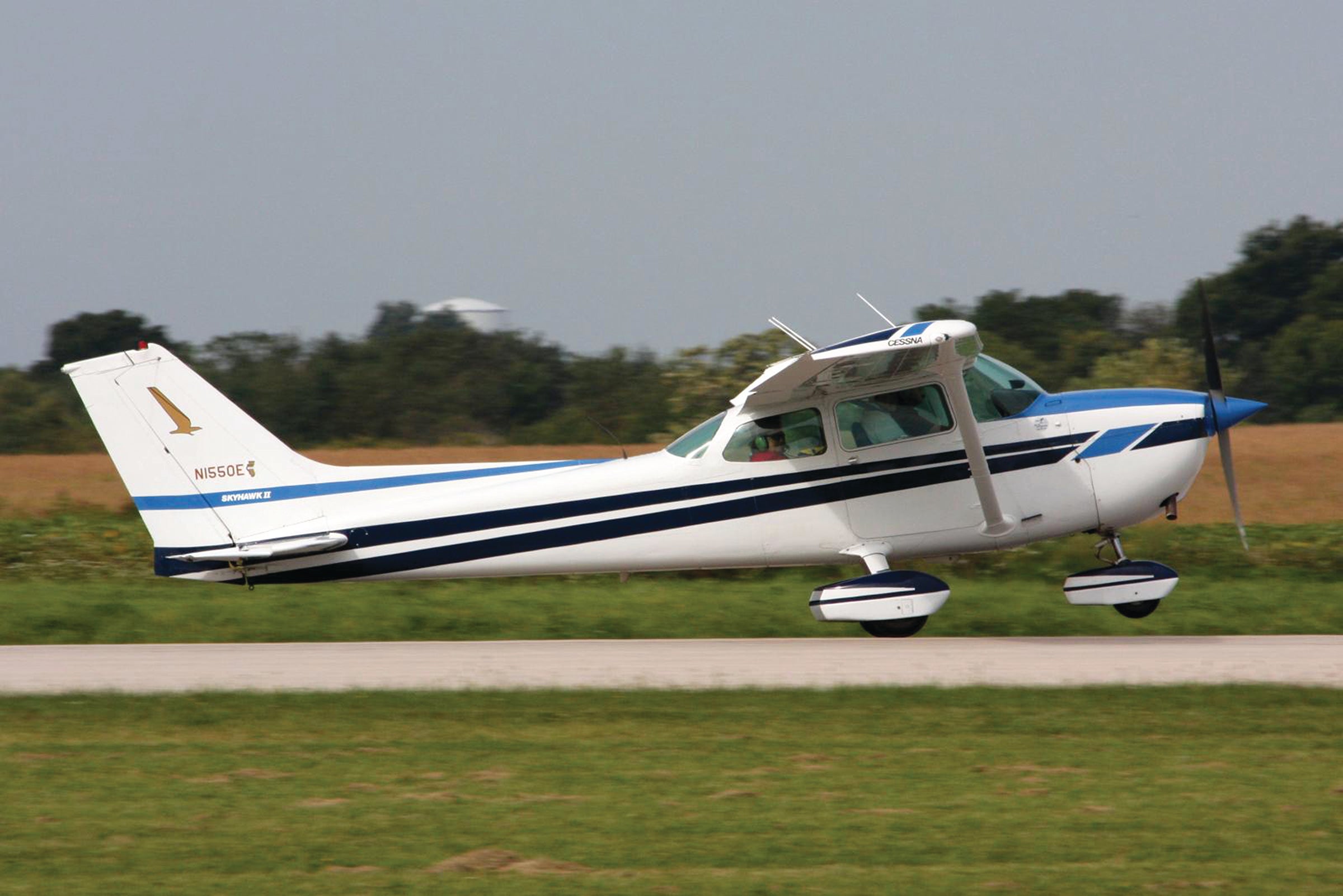

On July 29, 2017, at about 1420 Pacific time, a Cessna 172N Skyhawk was substantially damaged when it collided with mountainous terrain shortly after taking off from Big Bear City Airport (L35), Big Bear, Calif. The commercial pilot and passenger were fatally injured. Visual conditions prevailed.
An airport surveillance camera captured video of the airplane departing Runway 8 normally and beginning to climb. A witness near the departure end of the runway observed that the airplane did not gain altitude as it entered a nose-high attitude he described as “hanging on the prop.” The engine sounded smooth and continuous. As the airplane reached a park adjacent to the departure end of the runway, it turned to the crosswind traffic pattern leg momentarily before turning onto a tight downwind. Both turns appeared coordinated, but the airplane maintained a nose-high pitch attitude. The airplane then sank slowly and the wings began to rock back and forth before it disappeared behind trees.
Another witness observed the airplane flying low toward the south over him. The airplane began a turn to the right, then disappeared over the back side of an adjacent hill. The witness reported the airplane’s engine sounds were steady.

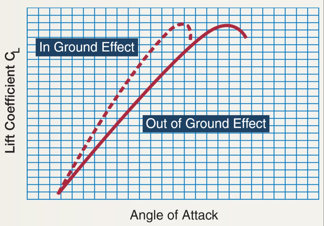

According to the FAA’s Pilot’s Handbook of Aeronautical Knowledge (FAA-H-8083-25B), “Due to the reduced drag in ground effect, the aircraft may seem capable of takeoff well below the recommended speed. As the aircraft rises out of ground effect with a deficiency of speed, the greater induced drag may result in marginal initial climb performance. In extreme conditions, such as high gross weight, high density altitude, and high temperature, a deficiency of airspeed during takeoff may permit the aircraft to become airborne but be incapable of sustaining flight out of ground effect. In this case, the aircraft may become airborne initially with a deficiency of speed and then settle back to the runway.”

  4. When it comes to ground effect, in a high wing aircraft like a Cessna 172, you’re behind the eight ball from the ‘get go’. Even sitting on the ground, you’ve lost 50 percent of the ground effect. Put a mere 5 feet of air beneath your wheels and you’ve lost 80 percent. Basically, most GA aircraft don’t benefit that much from the benefits of ground effect.
    My aircraft (RV-7A) is on a par with a 172 because of the short wing (25’); I lose 50 percent of the ground effect before I lift off. If I rise five feet in the air, I, too, lose 80 percent of the benefits.
    I think people put a little too much stock in the benefits of ground effect for GA aircraft; to gain access to what little benefit there is requires that the wheels stay a foot or two off the ground while we accelerate. You put 10 feet of air under the wheels of a 172 and you’ve lost 90 percent of the benefit. If I put 10 feet of air under my wheels, I lose about 92 percent of the benefit.
    Who benefits the most? Gliders and others with long wings relative to their height sitting on the ground…
