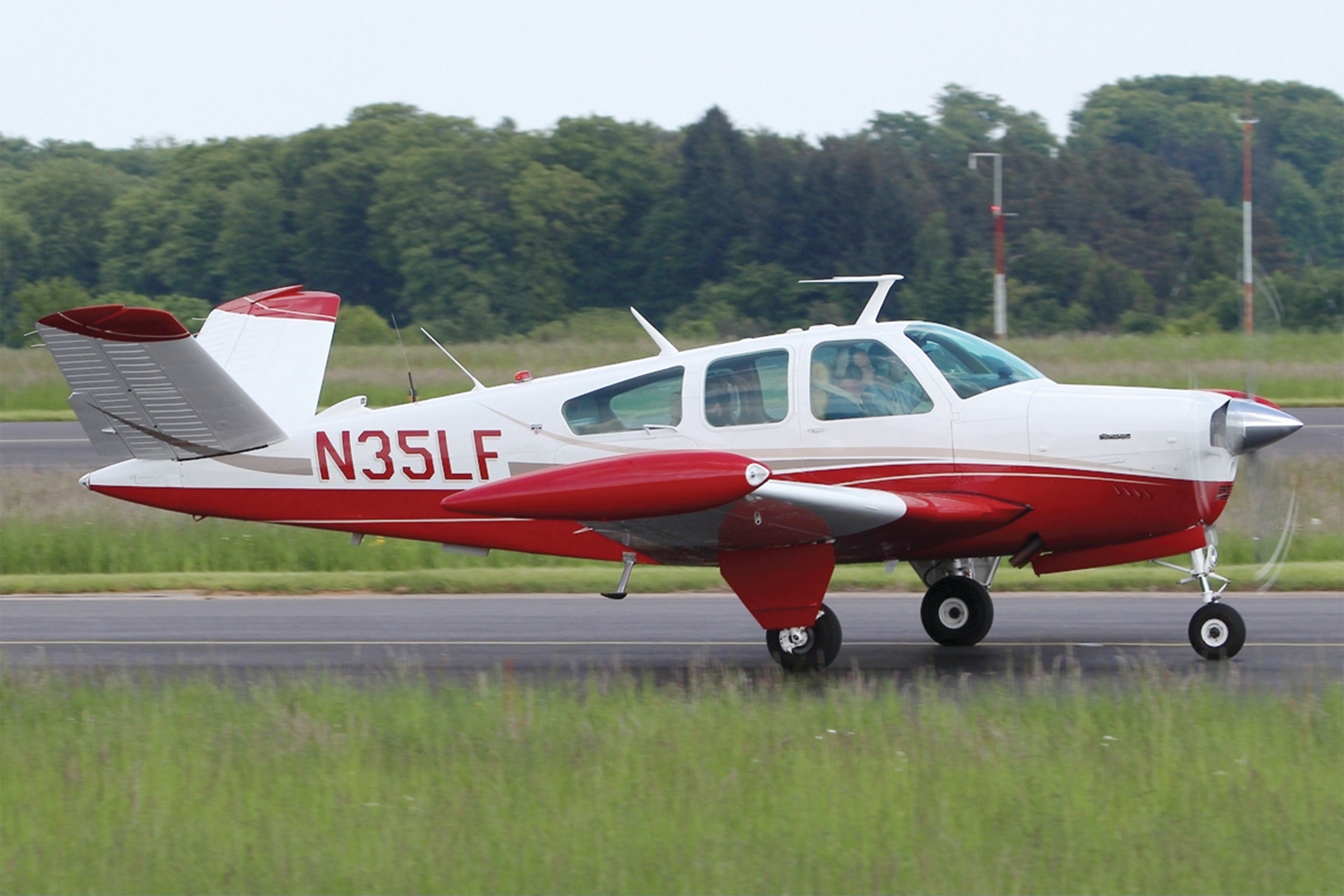

Bonanza V35B = Single engine aircraft with V-tail
Accident aircraft = Left engine has cowling trouble (I don’t think Beech made a twin with V-tail, but an aftermarket company did one called a Super V)
Photo Aircraft Caption = B35B which isn’t an official model. Appears to be a V35B as mentioned in the opening description of the accident aircraft. There was a B35 (no B on the end) but it was a 1950 model without the extra side window of the photo captioned aircraft.
I am not even a Bonanza guy and got confused from the get go about how a single-engine aircraft has a left engine without having a right engine also. What am I missing?
Okay. I think I got it now. Nobody bothered to add the word “door” to the cowling description. It would be better expressed as “the left side cowl door”. Not just the left cowling. Cowling implies a whole assembly and adding “left” just makes it worse. Cowl door implies part of the assembly and door gets us to exactly what we are talking about. Left side cowl door.
its not a door, it’s the whole upper side of the cowling that opens…hinge running right along the top
“It is likely a latch for the left engine cowling opened in flight because it was not properly secured during the preflight”…
better worded, it is likely that the engine cowling’s left hand side had opened
The Bonanza POH refers to “right and left engine cowling.” There is no “door” in the V35B Bonanza cowling.
