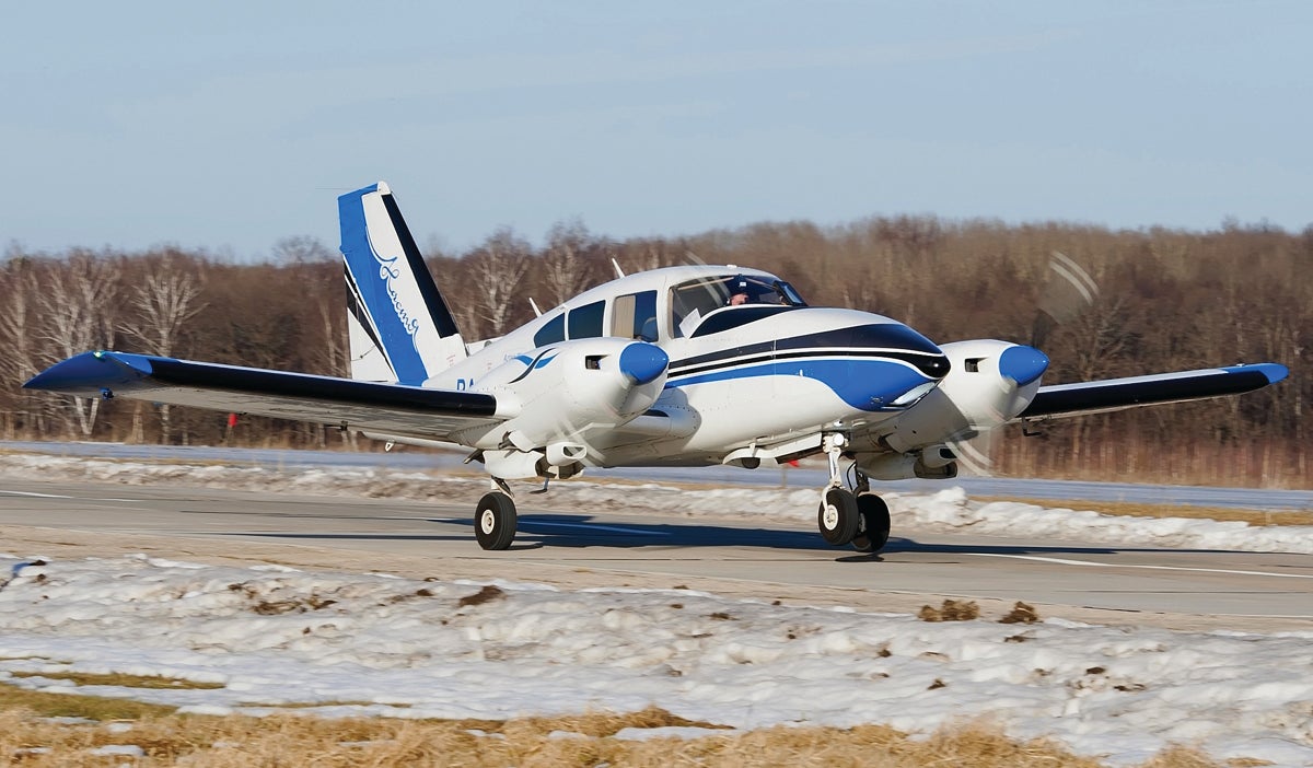

Aircraft Profile: Piper PA-23-250 Aztec E
Image: Alexander Markin
OEM Engines: Lycoming IO-540-C4B5
Empty Weight: 3042 lbs.
Maximum Gross Takeoff Weight: 5200 lbs.
Typical Cruise Speed: 170 KTAS
Standard Fuel Capacity: 144 gal.
Service Ceiling: 21,100 feet
Range: 722 NM
VS0: 59 KIAS
