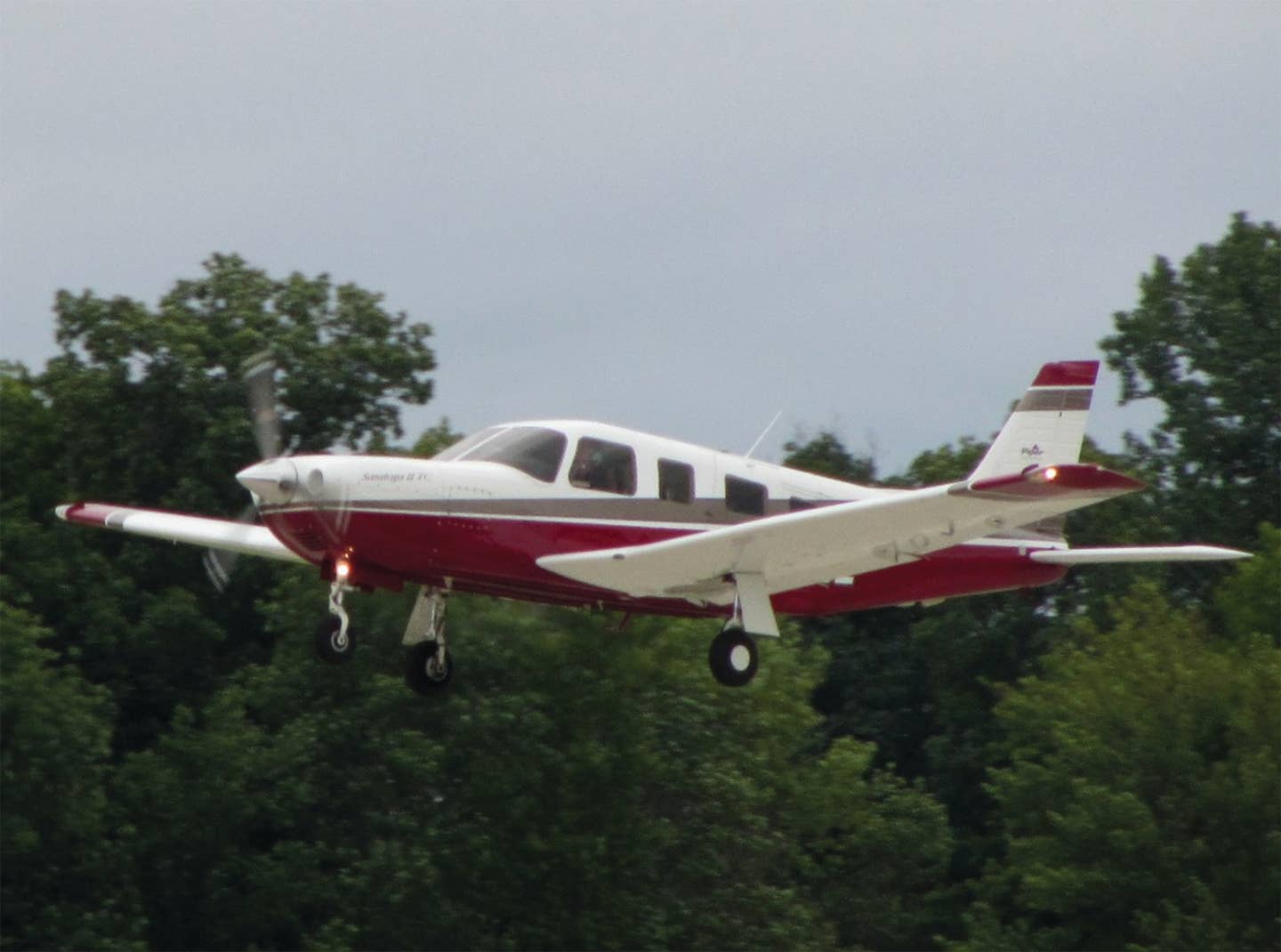

Aircraft Profile: Piper PA-32R-301T Saratoga II TC
Not accident aircraft.
OEM Engine: Lycoming TIO-540-C1D6
Empty Weight: 2464 lbs.
Maximum Gross Takeoff Weight: 3600 lbs.
Typical Cruise Speed: 177 KTAS
Standard Fuel Capacity: 102 gal.
Service Ceiling: 20,000 feet
Range: 822 NM
VS0: 60 KCAS
