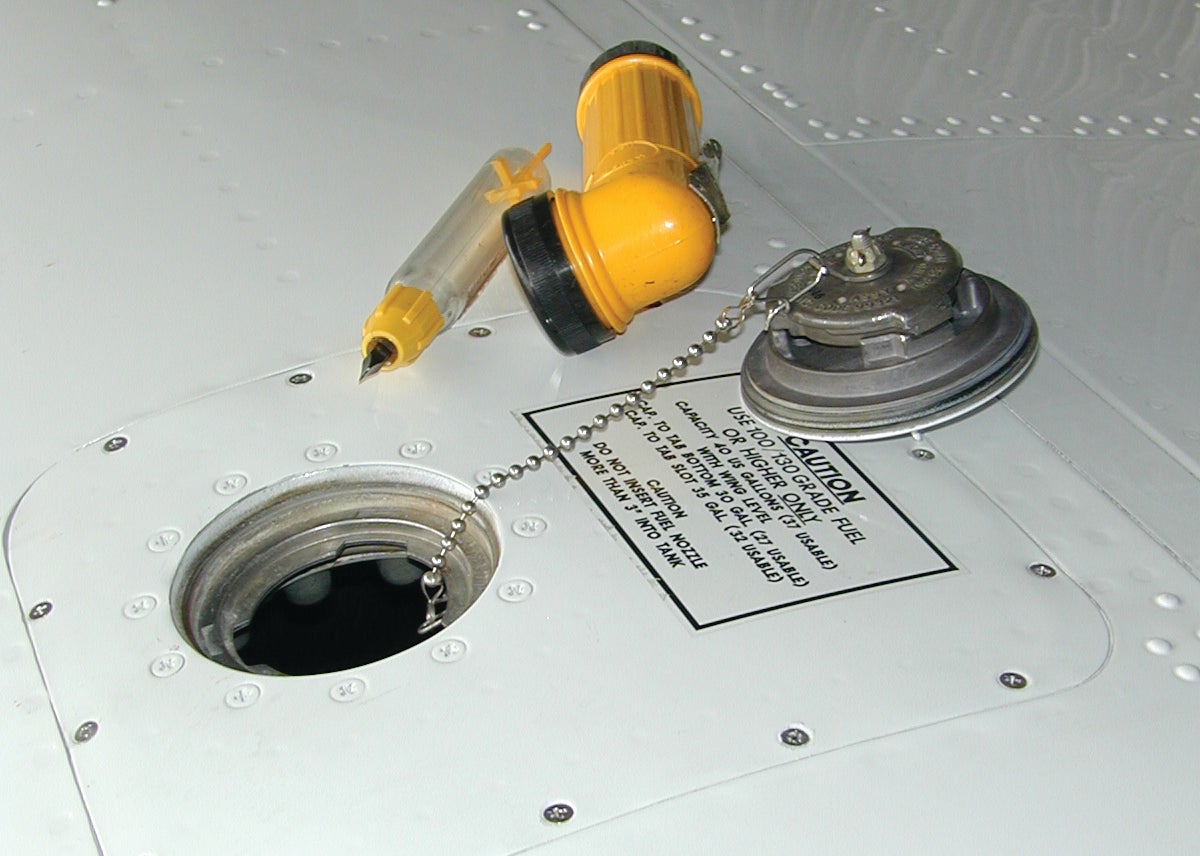

That exception to all of the airplane’s components being at the accident site? The airplane’s left main fuel tank cap was found about 4500 feet south of the rest of the wreckage, on the left side of the runway at the 1000-foot marker. The locking lever was engaged, and the cap showed no fire or impact damage.

The NTSB added: “It is likely that the left main fuel tank cap was not secured after the airplane was refueled and fell off the airplane’s left wing onto the runway during the takeoff. Without the cap in place, fuel escaped from the left main fuel tank and subsequently starved the engine of fuel during the climb, resulting in the power loss. The pilot likely switched the fuel selector to the right main fuel tank in an attempt to restart the engine. When the pilot tried to turn back to the airport, he failed to maintain a safe airspeed, and the airplane exceeded its critical angle of attack and entered an aerodynamic stall.”
The NTSB’s scenario is a likely one, and we can imagine reacting in similar way to the situation. At that altitude, however, the apparent attempt to turn back to the airport simply wasn’t going to work—it would have been better to land straight ahead. And we’re rather impressed at the speed with which a fuel tank can be emptied when its cap is missing.
Although we’ll never know how and why the left main fuel cap wasn’t properly secured after refueling, it could have involved miscommunication between the two pilots or the pilot-rated passenger’s unfamiliarity with the cap itself. But it likely came down to an interruption in the pilot’s routine, and a failure to verify everything was secured after the refueling.
