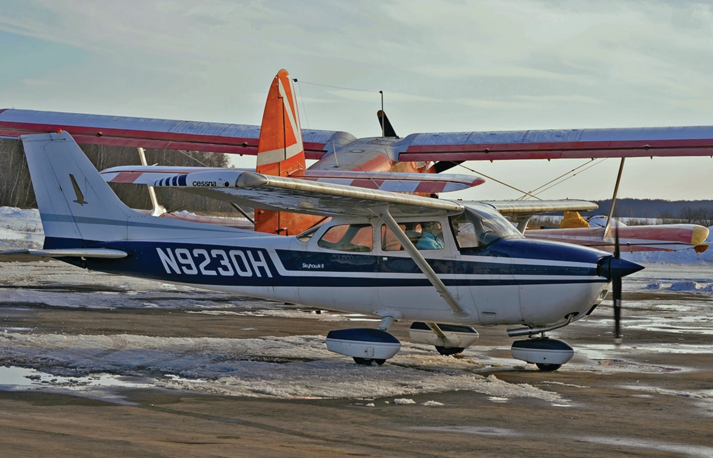

Aircraft Profile: Cessna 172M Skyhawk
Image: Aleksandr Markin
OEM Engine: Lycoming O-320-E2D
Empty Weight: 1335 lbs.
Maximum Gross Takeoff Weight: 2300 lbs.
Typical Cruise Speed: 115 KTAS
Standard Fuel Capacity: 42 gallons
Service Ceiling: 13,100 feet
Range: 435 NM
VS0: 44 KIAS
