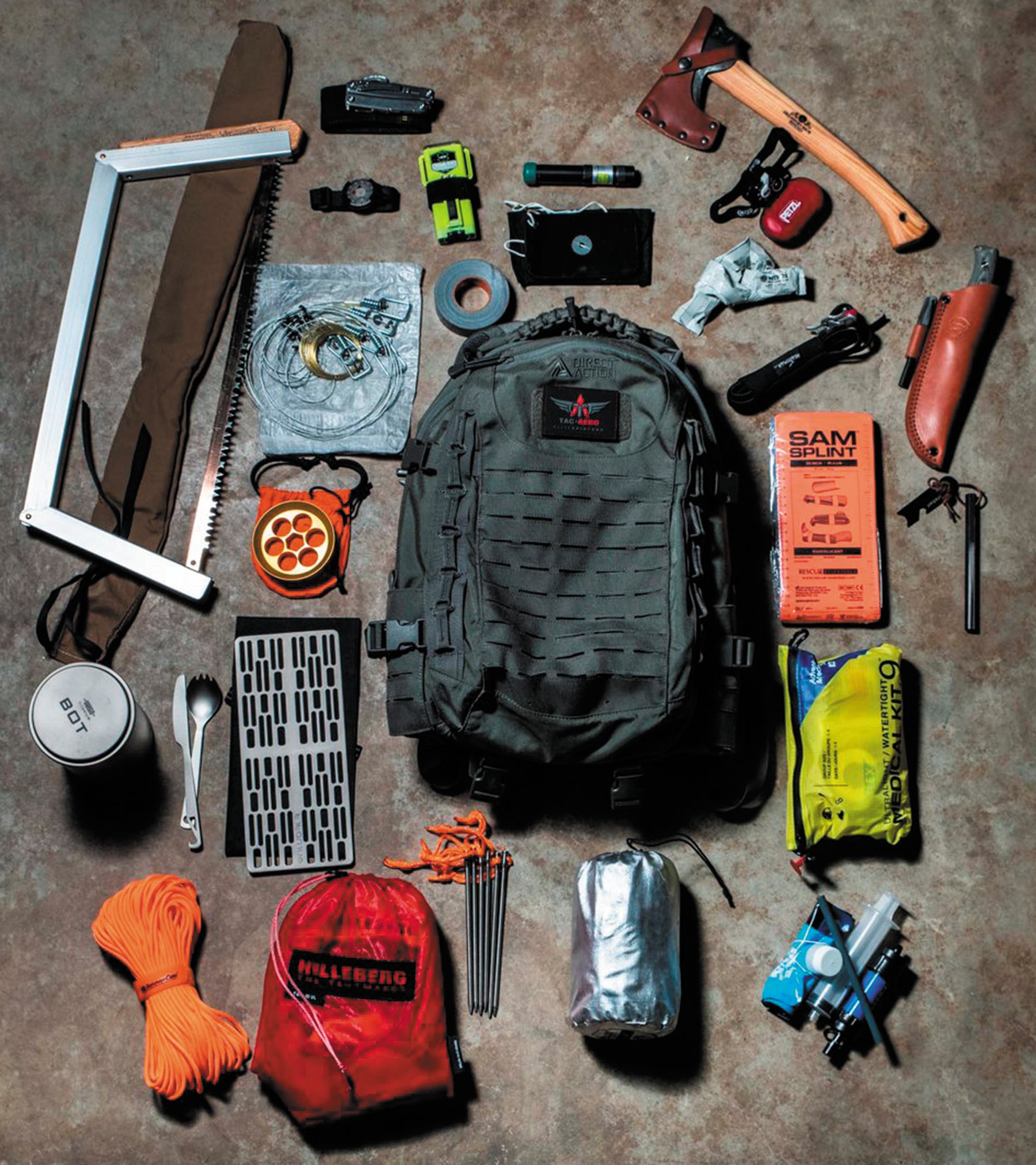

Survival Gear
There are many survival kits available for purchase but make sure the one you choose fits the needs for the areas you frequently overfly.
Always carry a survival kit on board for every flight. However, one size does not fit all. The survival kit should be tailored for the route and conditions of your flight. While there are essential items that should be in all such kits, there are others that are more germane for the particular flight, such as life vests or rafts for extended over water flights or a portable saw for over forested areas.
You can get carried away with what items to bring along, though it is better to over than under prepare.
One item I recently came across that I think is a vital addition to any survival kit is a solar charger for a phone. Your phone is your lifeline in a crash. Cell phones can be used to triangulate the position of a person. Not only does it provide communications capabilities, but it can help you navigate to more hospitable terrain if necessary or even civilization. It also has a light as a backup for a flashlight.
We have all become dependent on cell phones, but they are only useful if you have cell coverage. In remote areas, the phone may be useless for communications . However, it can still be a valuable tool for navigating to nearby civilizations. I recently heard of an aircraft that went down in the Florida swamp. The survivors proceeded on foot in the wrong direction, taking them deeper into the quagmire. Had they looked at their phone, they would have discovered there was a road nearby.
