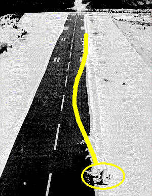

The next day, the NTSB accident investigator discovered thatthe Jetstream had touched down on the runway, but well leftof the centerline and on the unplowed portion of the runway.It rolled through the thick snow for 435 feet, at which pointthe right gear leg sheared off and the left gear began collapsing.
The airplane then slid out onto the plowed portion of the runwayand nearly reversed direction before coming to rest atop thesnow berm along the runway edge. The crew and two passengersescaped without serious injuries.
