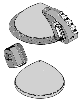

![]() List price for this Grimes retractable landing light assembly is $4,620.54 . Just the motor alone costs $1,827.00. At these prices, it’s certainly worth trying to fix. |
Another item on my discrepancy list for that same annual was the righthand retractablelanding light: it was retracting very slowly and making a funny noise. This sameretractable landing light assembly (originally made by Grimes) is used in virtually alltwin Cessnas from 310s to 421s. Cessna lists the full landing light assembly at abreathtaking $4,620.54, and a replacement "power unit" (motor) at a mere$1,827.00. So it was pretty much a no-brainer that I was going to take this thing apartand try like heck to fix it.
It took me the better part of an hour to get the power unit completely disassembled. Atfirst, it wasn’t obvious what was wrong. I did notice, however, that the motor had amagnetically-operated brake built into it, and theorized that perhaps the brake wasdragging.
There didn’t appear to be any kind of brake adjustment, but it looked to me like maybeif I bent the brake assembly just a little, it might work better. I did that, reassembledthe unit, and gave it a test.
Oops! The landing light retracted even slower than before and made more noise thanbefore. Hmmm.
I took the whole thing apart again (more quickly, because this time I knew the drill),bent the brake assembly in the opposite direction, and put it back together again. Thistime, the retraction was perfect and the unit sounded normal. Another problem solvedwithout the need to take out a second mortgage!
