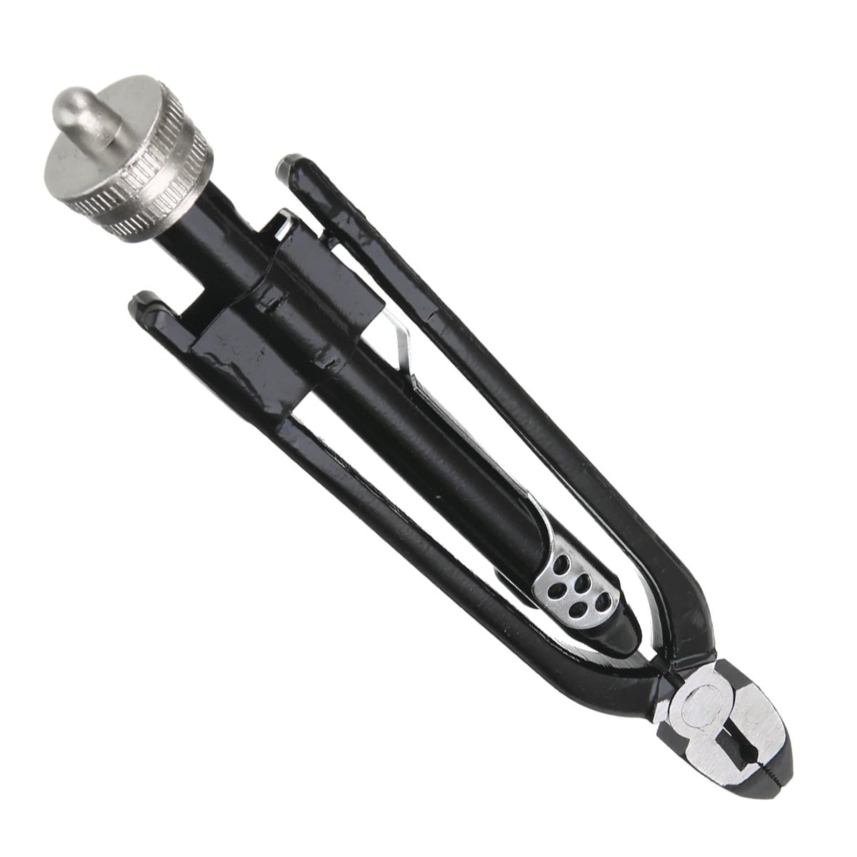

Safety-Wire Pliers
Even if you don’t do your own oil changes and need to reinstall the filter’s safety wiring, these locking pliers can come in handy for other tasks around the house, hangar or workshop. A decent pair can be found for around $15. Practice learning to use them before safetying anything important.

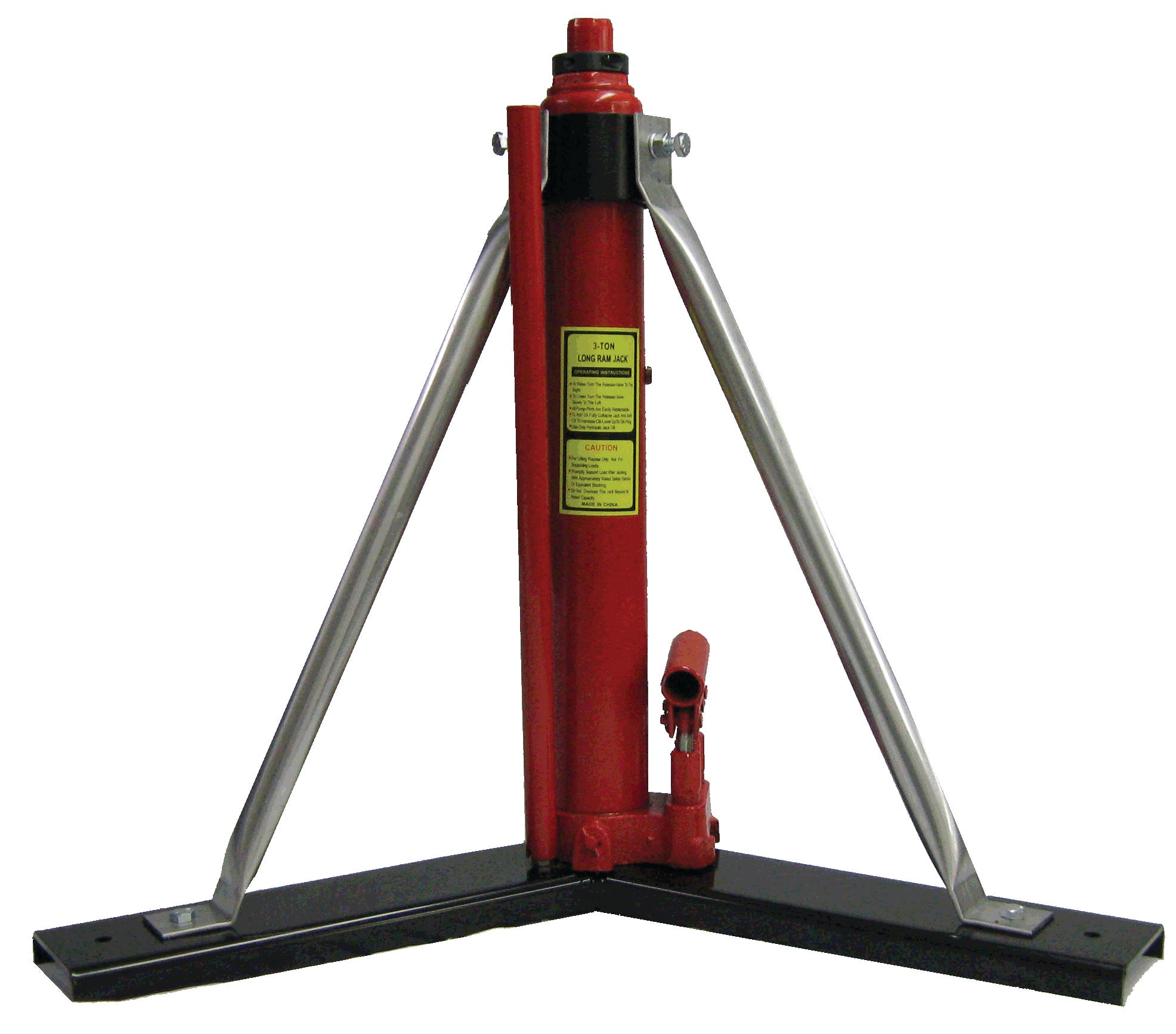

Jacks
If you plan to change your tires or perform other wheel-related maintenance, you may need a suitable set of jacks. They’ll also be handy if your IA comes to your hangar for an owner-assisted annual. In addition to the jacks, you may also need some ballast at the tail to keep the nosewheel off the hangar floor.

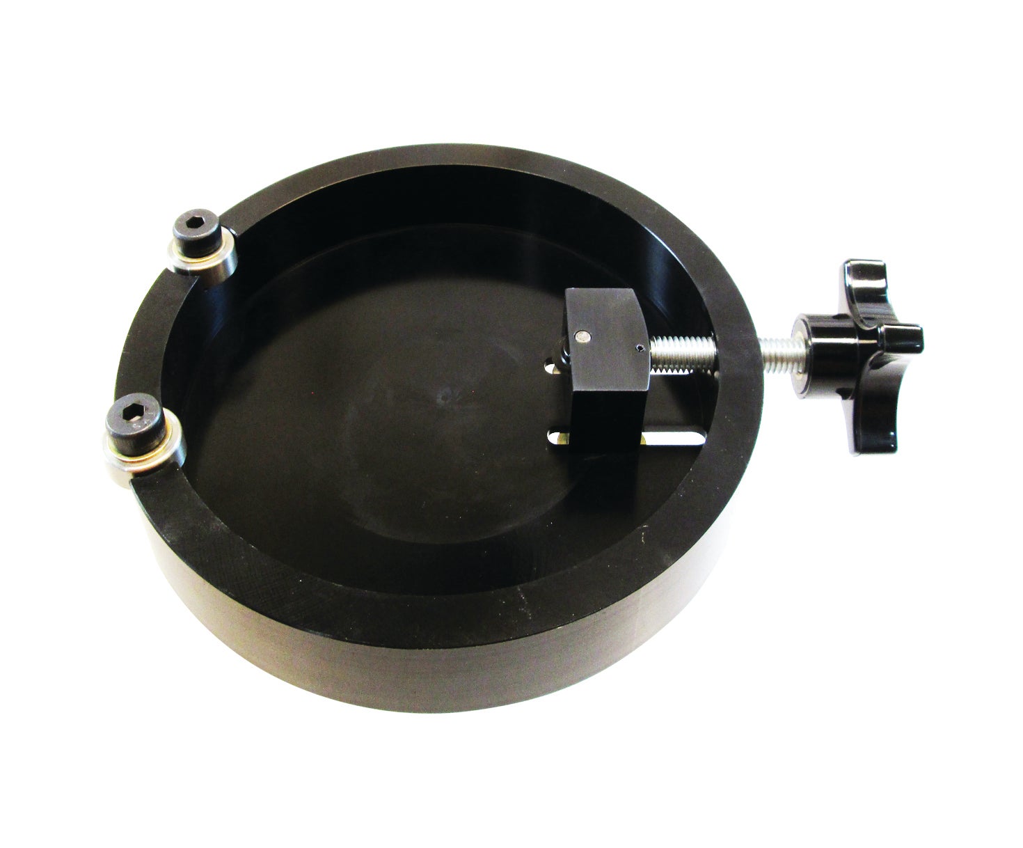

Filter Cutter
After you change the engine oil and filter, it’s always a good idea to cut open the filter for inspection. This can be a slippery task, one that’s made easier by using a purpose-built device designed to cut off the filter’s bottom mounting plate, allowing the filter material itself to be removed and its pleats explored for shiny metal bits. If you find any, consult your mechanic.

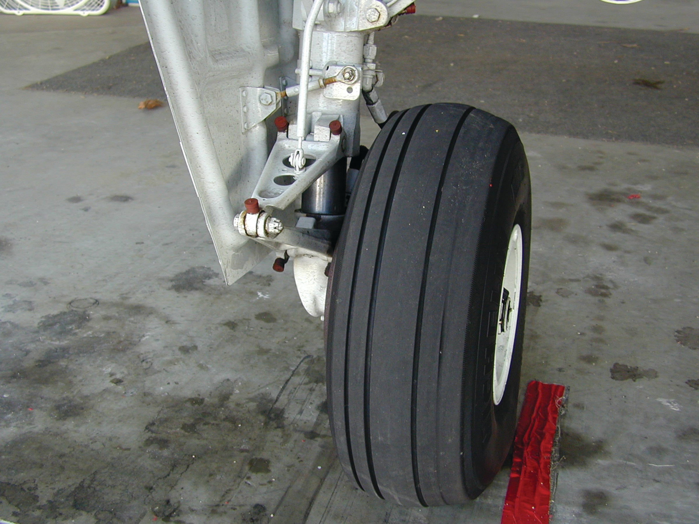

In part because it’s usually easy to get to, landing gear lends itself to PM tasks. At the right, this Bonanza’s main gear tire looks worn and is ready for replacement. Wiping down the strut and lubricating a retractable’s landing gear pivot points with a grease gun are tasks pilots are allowed to perform on their own aircraft, along with changing the worn tire.
