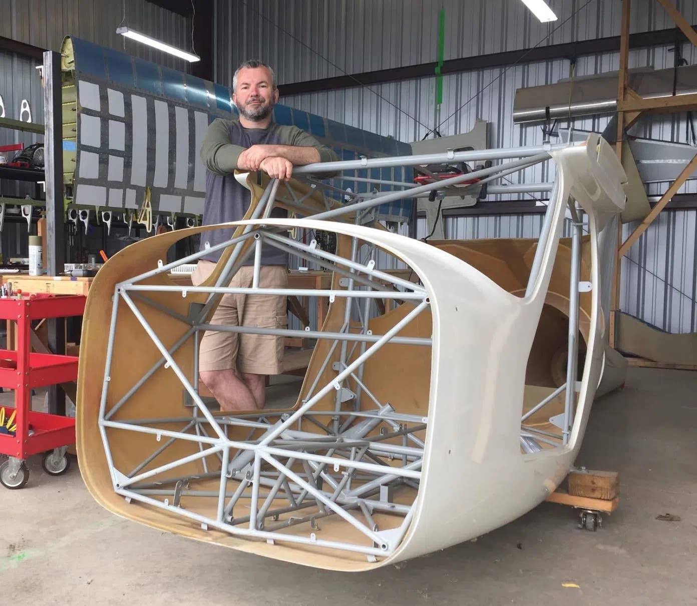

Omar Filipovic has been the Kitplanes’ Web Editor since 2009. He is building a GlaStar while also acting as president and janitor of the Glasair Aircraft Owners Association. He earned his Private Pilot certificate in 1994 and if he ever grows up, he wants to be a ski bum.
