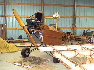

A Pietenpol under construction in a hangar at Brodhead. This Air Camper has a one-piece wing and Ford power.
Even the size of the builder may influence the choice of a long or short fuselage. The long fuselage provides an additional two inches of legroom in both the front and rear cockpits. Some builders have even opted for adding width to the fuselage. Many add to the length of the cabane struts, raising the wing up to four inches for easier access to the ‘pits. This is especially helpful as far as getting into and out of the front hole. Going to Brodhead allows the builder to talk to builders with finished airplanes about the relative merits of these and other tweaks to the basic design.

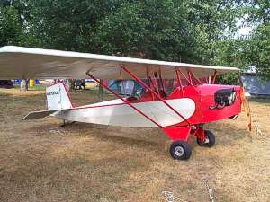

Jim Kinsella’s beautiful Continental A-65 powered Air Camper.
Several Piets drew my attention. One was Bill Rewey’s Continental-powered Air Camper, which I had seen and photographed at Oshkosh last year. Bill’s Piet has several useful additions, including a simple but effective trim system using a screen door spring and an Adel clamp and a very good brake pedal/master cylinder installation. He’s also generous with providing drawings and had sent me the plans for his brake installation. I stopped to say hello.
Jim Kinsella, of Louisville, Ky., brought a beautifully finished Continental-powered Air Camper. I snapped numerous pictures of his simple but effective cowling and main gear/fuselage bracket attachments, which may well end up being imitated on my airplane. Piet builders are famous for scavenging parts from a variety of sources, but we are even more avid idea scavengers.

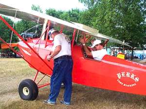

Another notable airplane on the field was Ken Perkins’s orange/red Ford-powered Piet, “Perk’s Time Machine.” Like Kinsella’s, the workmanship was superb. The Ford engine was tuned perfectly and ran smoothly with no characteristic popping. Perkins’s Piet went on to win a bronze Lindy at Oshkosh the next week. It deserved it.

Ken Perkins shines up his Lindy-winning Pietenpol at Brodhead.
For serious builders, Brodhead offers forums where experts pass on some of their accumulated knowledge and answer questions. Ken Perkins gave a presentation on one of the mistakes he made in building his award-winning Piet. Like all of us, he had to redo some parts and assemblies because he wasn’t satisfied with them or they didn’t perform to his standards. He covered some of the known problem areas with the design and with the Ford Model A engine conversion.
