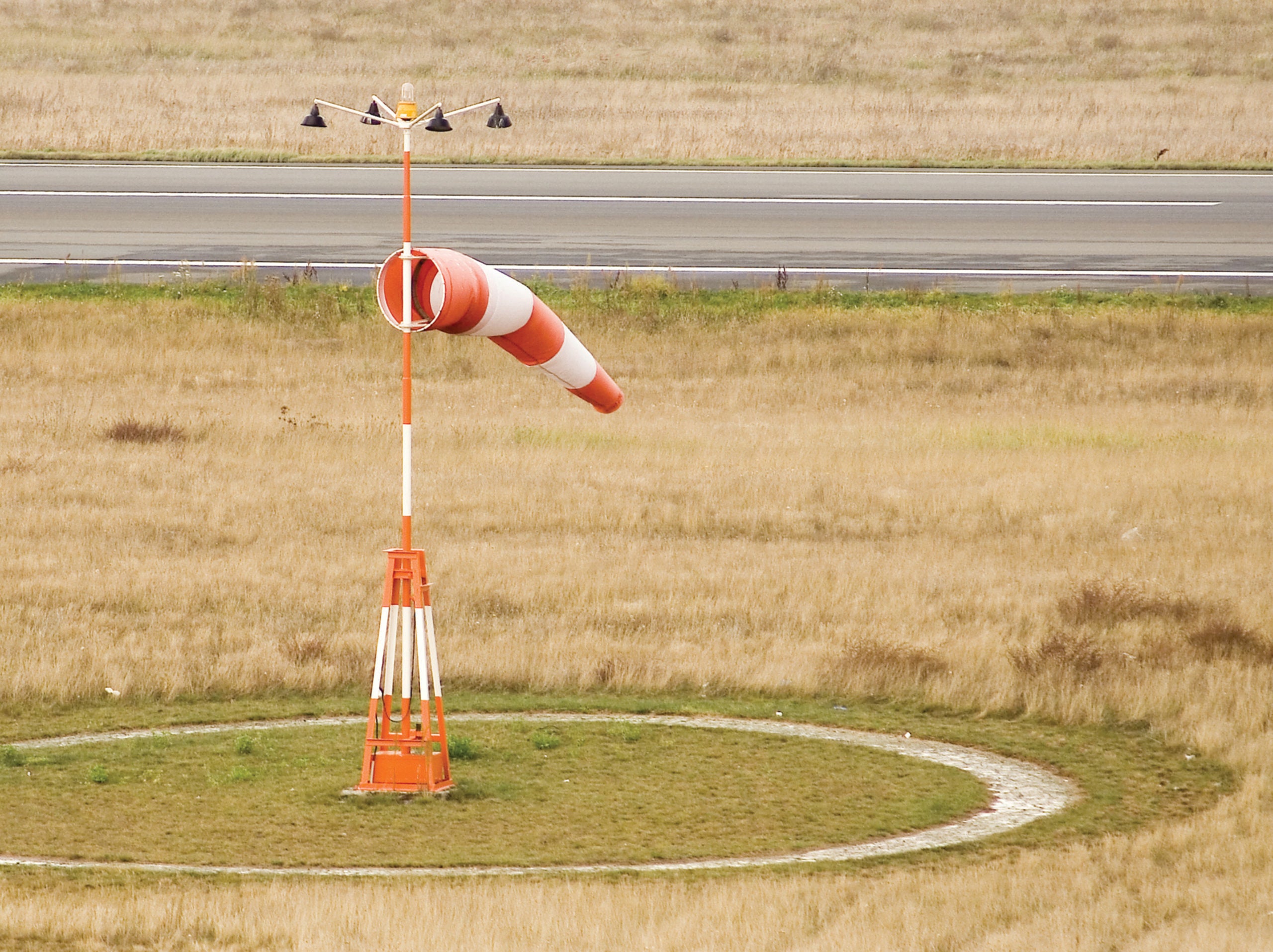

Crosswind Component
Perhaps the most-violated limitation pilots face isn’t really a limitation at all. I’m thinking of the published maximum demonstrated crosswind value found in AFMs and POHs. It’s often thought of as a rule, or limitation, but it’s usually neither, depending on how the POH/AFM is written. Instead, it’s usually informational and merely advises that, during flight testing, the stiffest crosswind the test pilots were able to find was of the published value.
There are some FAA rules behind the maximum demonstrated crosswind component. For example, the agency requires a manufacturer to demonstrate, during the airplane’s type certification process, that it is controllable in 90-degree crosswinds up to 20 percent of VS0, the stall speed in the landing configuration. The test pilot flying it supposedly does not use exceptional skills to perform the demonstration. That’s it, and presuming the test pilot didn’t ding the airplane, the demonstrated crosswind component on that day appears in the POH/AFM. Can you exceed it, legally? Usually—unlike some other things you can do in an airplane that exceed its limitations or recommendations—and it can be relatively easy, especially if there’s plenty of runway length and width to work with (see the sidebar “Playing Crosswinds For Keeps” below).

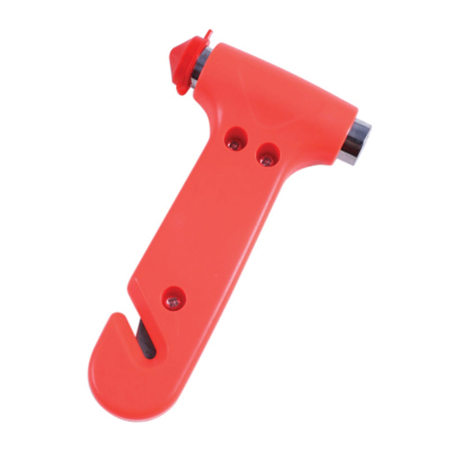

Vertical Speed Indicator
Those of us flying around behind glass panels since birth may not even have a separate, “steamgauge” vertical speed indicator (VSI), but anyone who’s flown a round-dial airplane should be familiar with the instrument. Of the conventional six-pack of flight instruments, it’s the only one not legally required for IFR. In fact, the FAA, via the Pilot’s Handbook of Aeronautical Knowledge (PHAK, FAA-H-8083-25B), states, “If the VSI indicates anything other than zero, that indication can be referenced as the zero mark.” Why is this important? Because the VSI is one of those things on an airplane that can be intentionally broken to resolve a problem.
Elsewhere in the PHAK, the FAA notes, “In an aircraft not equipped with an alternate static source, an alternate method of introducing static pressure into the system should a blockage occur is to break the glass face of the VSI. This most likely renders the VSI inoperative. The reason for choosing the VSI as the instrument to break is that it is the least important static source instrument for flight.” Breaking the glass on the VSI bypasses the static-system blockage, and once again allows ambient pressure to be used by the airspeed indicator to measure the difference between it and the higher-pressure air flowing into the pitot tube, as well as “fixing” the altimeter.
Two things: One, and as the PHAK points out, the VSI likely won’t be usable once its glass face is broken. That’s okay, since we’d be needing a static source more than the VSI. The other thing is it might not be easy to break that glass—it’s not an iPad (although you could maybe use an iPad to break it). Some old-school pilots flying old-school airplanes carry a so-called “glass hammer,” which are popular with motorists who fear being trapped in their car after an accident. Glass hammers—see the sidebar “Break Glass In Case Of Emergency” below for an example—have a hard, sharp, metal head designed to break automotive glass and sometimes even feature a built-in seat-belt cutter. All in all, they’re not a bad thing to stash in your airplane’s glovebox, even if you don’t have a VSI.

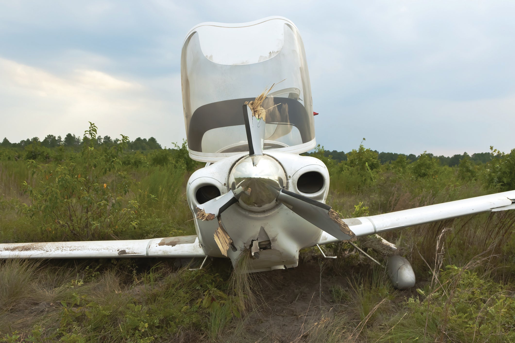

The Airframe
A final thing we can break in an emergency is the airframe. A classic example might be pulling the airframe parachute handle on aircraft equipped with them. That’s completely legal, by the way, since the airplane was type certificated or STC’d for the parachute and its deployment. (If you’re just trying to find a dramatic way to break a FAR, you’ll have to keep looking.) Another might be the aforementioned landing-gear extension, which in extreme situations is likely to break something. That having been said, I’m a strong advocate of sacrificing all or part of the airframe if doing so may enhance the occupants’ survivability.
Another classic example of what we’re discussing is the engine-failure scenario where there’s no chance to glide to a runway. In fact, your best bet may be an open meadow, with trees and stumps. In such an event, Job One is to manage the airplane’s deceleration so that there are no sudden stops. That task begins with extending the landing gear—if it’s still attached— allowing it to absorb energy and even break away in an off-field landing.
Avoiding sudden stops is what it’s all about in an off-field or crash landing, and you likely have a couple of rather large energy absorbers on either side of the cabin: the wings. Old-school pilots have long maintained that it’s better to steer the crashing airplane between two trees and allow them to remove the wings—dissipating that much more energy—than it is to aim for the tree and hit it head-on.
If you own the airplane, like I usually do, you might be very reluctant to slide it between a couple of trees—and it’s definitely considered bad form to run it between the only two trees in a nice, smooth meadow. But if a single’s engine quits and you have to put it down anyway, it already belongs to the insurance company. When it comes to a stop and you climb out, use your cellphone to call the insurance company and tell them about the slightly used airplane they just bought.
If the wind across the runway is honking beyond the airplane’s max demonstrated capabilities, can you still land or take off? As this article’s main text covers, the answer is yes. But how?
One answer is to find the longest, widest runway available. You need the extra pavement because you may want to accelerate and decelerate more slowly than usual, to help maintain control, and provide some error margin if you need it.
You also need good technique: Remember to position the flight controls correctly and keep the upwind wing down, into the wind, so it doesn’t get underneath and change the airplane’s trajectory.
If a long, wide runway isn’t available, forget about staying on the centerline. Instead, make your approach or plan your takeoff to angle into the crosswind, minimizing it. Use the downwind corner of the runway threshold as your starting point for a takeoff and your aiming point for a landing.
Finally, there definitely are crosswinds you shouldn’t tackle. Don’t feel the absence of a regulatory restriction on crosswind components is your license to fly in any conditions. Use some judgment and stay on the ground, or go somewhere else to land into the wind.
Pitot-static system failures are beyond this article’s scope, but it’s one of those things you’ll know when you see it: A blockage generally will cause the airspeed indicator (ASI) to show higher speeds in a descent and lower ones during a climb. That’s a bit insidious, since that’s what happens normally. To verify the blockage, slow the airplane by reducing power and maintaining altitude. If the ASI doesn’t change, you’ve got a blockage.
These days, many airplanes have an alternate static port, activated from the cockpit. If not, or you believe the alternate static system also has failed, you’re justified in breaking the VSI’s glass, which has the effect of creating a brand-new path for ambient pressure to be compared with the ASI.
