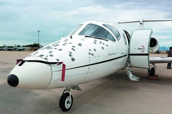

In flight, small hail can strip paint from the leading edges of wings, the tail and props while larger hail strikes can mean control surface failure. It’s easy to see why.
Designed to be strong where needed, our planes are built as light as possible using the thinnest aluminum sheet (or fabric) that is structurally safe. Aluminum takes it on the chin in a hailstorm. Even big iron with much heavier skins can get beat to death by hail.
