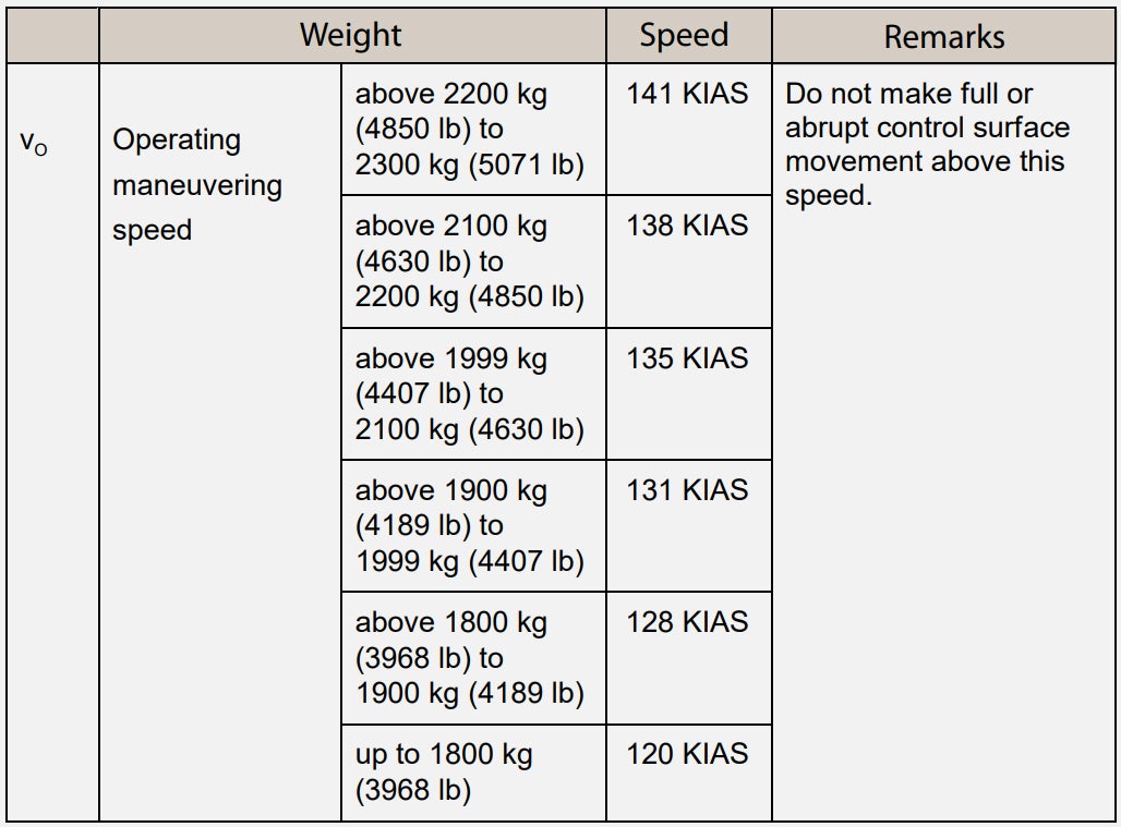

Adjusting Maneuvering Speed For Weight
We were trained that maneuvering speed (VA) is the speed above which full or abrupt control movements must not be made. Later, we learned we also shouldn’t fly in turbulence above this value. But we’re often not trained to reduce VA at lighter weights, although we should.
Recent AFMs/POHs and those for newer airplanes often include more than one maneuvering speed, for heavy, medium and light weights, perhaps labeling them “operating maneuvering speed,” or VO, as shown in the excerpt above, adapted from the Diamond Aircraft DA 62’s AFM. For those of us flying airplanes without such detail in their documentation, computing your weight-adjusted VA/VO is easy enough to do in your head using a rule of thumb. You simply need to know two values: the airplane’s maximum gross weight and its current weight.
The rule of thumb is for every two percent reduction in weight from max gross, reduce VA by one percent. As an example, presume an airplane with a 3600-lb maximum gross weight and a 110-knot maneuvering speed is being flown at 3000 lbs. That’s roughly 83 percent of its gross weight, for a 17-percent reduction from maximum. Half of 17 is 8.5. Reduce the 110-knot value by 8.5 percent, which gives us a rounded, new weight-adjusted maneuvering speed of 101 knots.
If doing math in your head isn’t your thing, you can make up a table with various weights and the appropriate speed, then tape it to the instrument panel, or include it in your electronic flight bag’s documents. In any event, remember that VA/VO is the maximum speed we should be flying in turbulence; this is one of those occasions when slower is better.

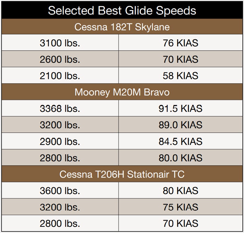

Best Glide Speed
When your single’s engine quits, you’re flying a glider. Among other tasks, you need to fly the airplane. But at what speed? Manufacturers give you a target number to use—the airplane’s best glide speed. The bad news is that a single number doesn’t tell the full tale because it’s usually published for maximum gross weight and should be revised downward at lighter weights.
The table at right presents the published weight-adjusted values for three popular singles. Notably, it’s a relatively recent trend for AFM/POH data to include such a range. For example, the POH for a 1977 Cessna 182Q Skylane contains a single number: 70 KIAS, at the airplane’s 2950-lb. gross weight.
The FAA’s Safety Briefing topic, “Best Glide Speed and Distance,” says the number will be “roughly halfway between VX (best angle of climb speed) and VY (best rate of climb speed).” The publication highlights the difference between best glide speed—which offers the greatest distance over time, versus minimum sink speed, the speed resulting in the lowest descent rate. The publication recommends doing some in-flight testing to nail these speeds for the airplane you fly.

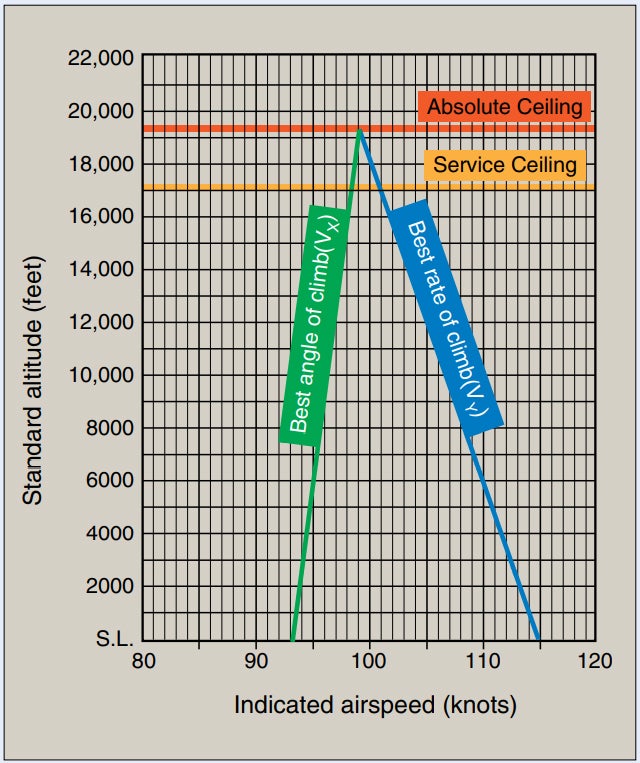

How Climb Speeds Change With Altitude
Putting aside the effects of weight on important airspeeds, we also need to understand how altitude impacts climb performance. Simply stated, best angle of climb (VX) increases slightly with altitude while best rate of climb (VY) decreases at a slightly higher rate. The graph at right shows the relationship, and that the two values are the same at the airplane’s absolute ceiling.
As we climb, there’s less air available to generate lift or make power. Since an airplane can climb only when available power exceeds what’s necessary to maintain altitude, the maximum climb angle occurs when the difference between power available and power required is the greatest. As power is reduced by altitude, maintaining VX places the airplane behind the power curve. To maintain the maximum angle of climb, we must lower the nose and accelerate. Meanwhile, when climbing at VY, best rate of climb, the less-dense air means less lift is being generated. To compensate and achieve maximum climb rates, we need to increase the angle of attack, which means flying more slowly.
This admittedly is something of a simplistic explanation; there’s more going on here—including propeller efficiency, induced and parasite drag and the relationship of true airspeed to indicated— than space allows. We’ll revisit this topic in an upcoming issue.
