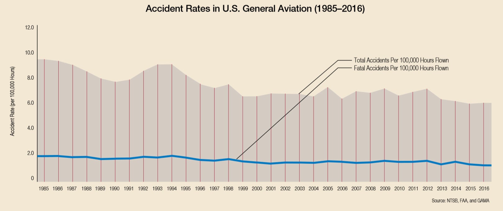

The general aviation accident record improved slowly and sporadically for many years, from horrible beginnings in the 1940s right up to around 2000. At that point, accident rates more or less flatlined until 2013. After a blip in 2014, it may be beginning a downward trend again. It’s still too early to tell if this trend will continue. The graph below shows the numbers and trends from 1985 through 2016.
This stagnation in the accident rate attracted the attention of both the aviation community and government, including the FAA and the NTSB, who collectively formed the General Aviation Joint Steering Committee (GAJSC), to address these and other concerns. I have recently covered these joint industry/government safety initiatives (“Making GA Safety Policy”), so I won’t repeat that discussion. As part of its activities, the GAJSC worked methodically to identify leading GA accident “causes” and to develop mitigations to reduce the number of these accidents.
Based on the data it uncovered from the NTSB’s findings of probable cause and the details of associated accidents, the GAJSC’s initial effort focused on LOC-I as the leading cause of fatal general aviation accidents. The GAJSC’s methodology included forming work groups to analyze candidate accidents, then develop mitigations—safety enhancements (SEs)—to reduce the number of LOC-I accidents. The work groups ranked the SEs by their presumed effectiveness, feasibility and cost using a complex multi-part formula that considered several factors. They then prepared detailed implementation plans (DIP) for the 34 highest ranked SEs. Additional details of these and other GAJSC efforts, plus comprehensive records of its deliberations, is available on the organization’s web site: www.gajsc.org.
A bumpy ride: GA accident rates basically flat-lined circa 2000 and haven’t fallen as much as many desired. Recent down-ticks may have legs, however. Chart courtesy of the General Aviation Manufacturers Association and its 2017 annual report.
