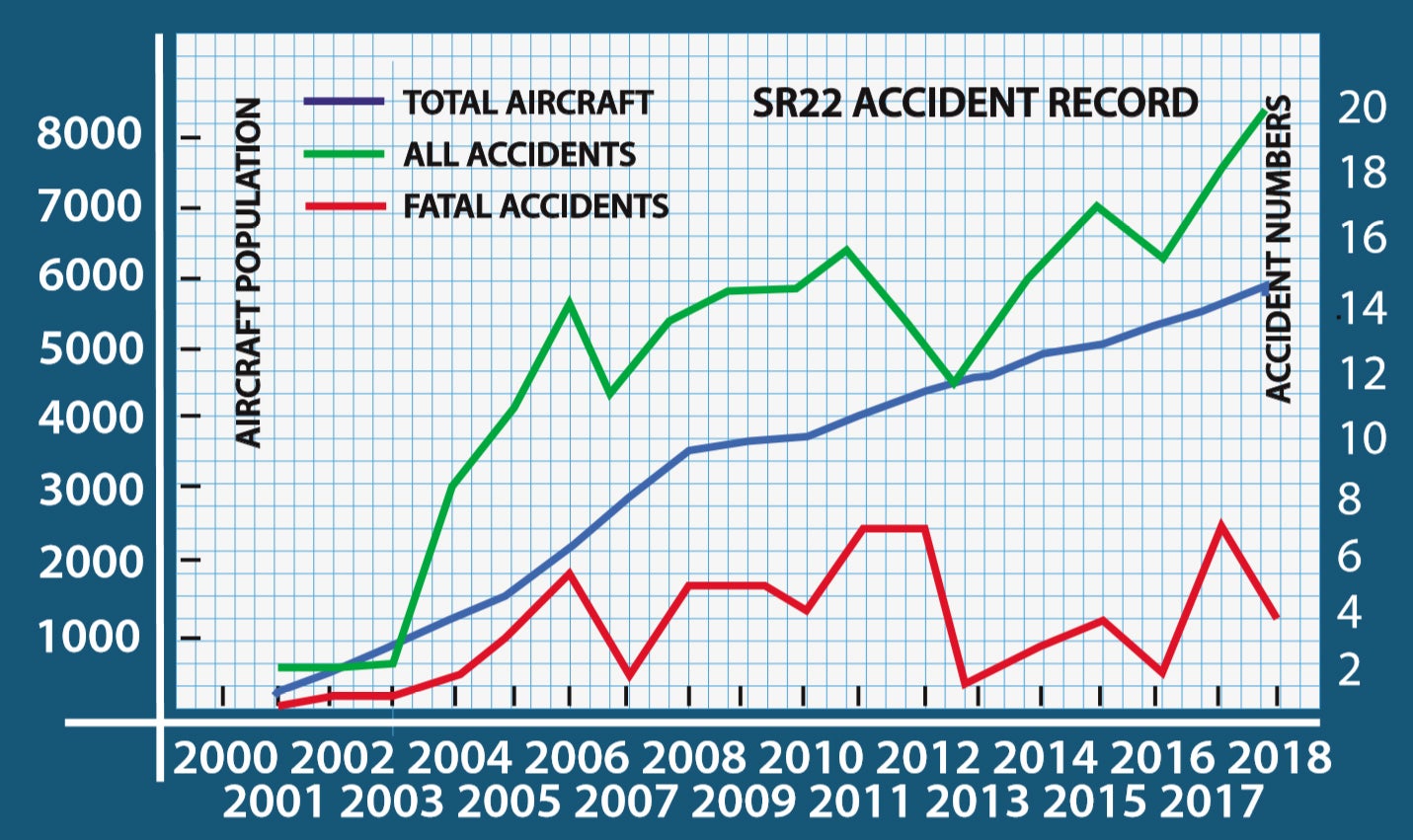

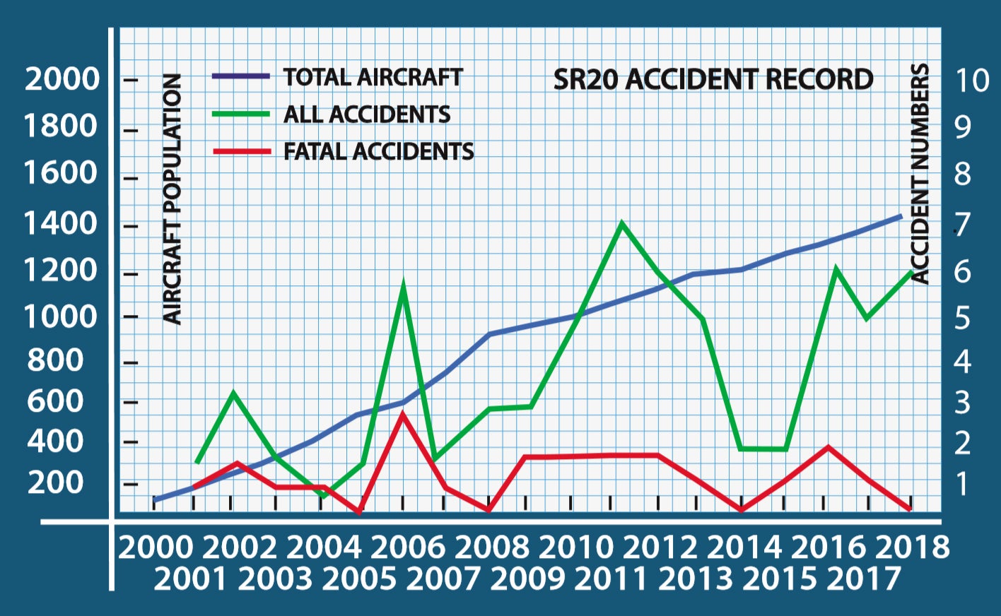

These graphics summarize the Cirrus SR20/22 accident trends from day one. The blue line represents aircraft population with the values depicted on the left. (Although the green all-accidents line appears above the aircraft population trace for the SR22, this is a limitation of the chart design and doesn’t mean crashes outpace production.)
A key takeaway is the red fatal-accidents trace. Despite some spikes, the directionality is essentially flat, which confirms a declining fatal accident rate because as more aircraft entered service and more hours were flown, raw numbers of fatal crashes haven’t increased.

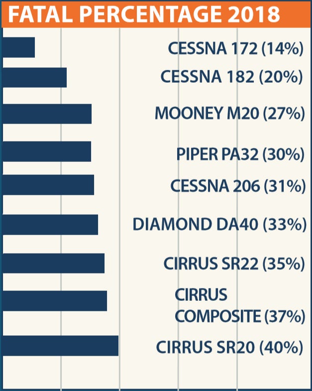

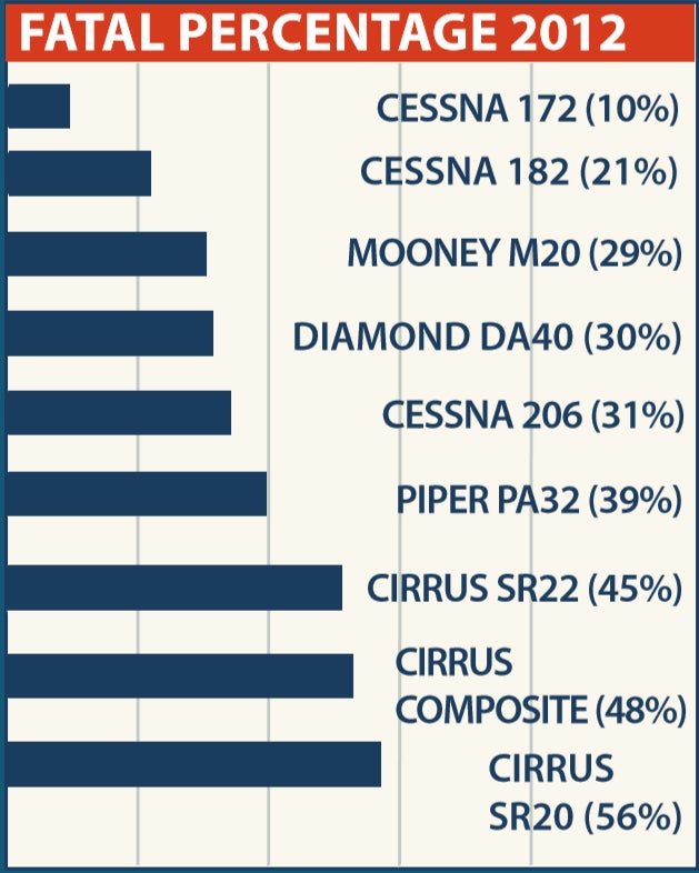

This is further confirmed by the percentage of accidents that were fatal, as depicted in the top charts. During the six years since we last examined Cirrus accident rates in 2012, the percentage of Cirrus crashes that were fatal has declined significantly for both models. Other aircraft we examined have remained relatively stable.
Total accidents are a different story, especially for the SR22. The green trace is spikey for the SR20 and shows a sharp rise after 2015. However, SR20 accident numbers have still been relatively stable as the fleet has grown. For the 18-year period we examined, the SR20 has averaged 1.2 fatal accidents per year.
Total accidents for the SR22, on the other hand, have trended upward since 2013 and reached a record peak of 20 total U.S. accidents in 2018. Only four of those accidents were fatal, which is in line with the 18-year average of 3.6 fatals per year.
If the Cirrus worldwide fleet hours-flown claim of a million hours per year is accurate, the worldwide overall accident rate for 2018 was 2.7/100,000 hours or less than half the 4.92 GA average. But the worldwide fatal rate just for 2018, at 0.6/100,000, is lower than the 0.80 GA average and lower than COPA’s 0.78 three-year rolling average, a trend that may or may not sustain.

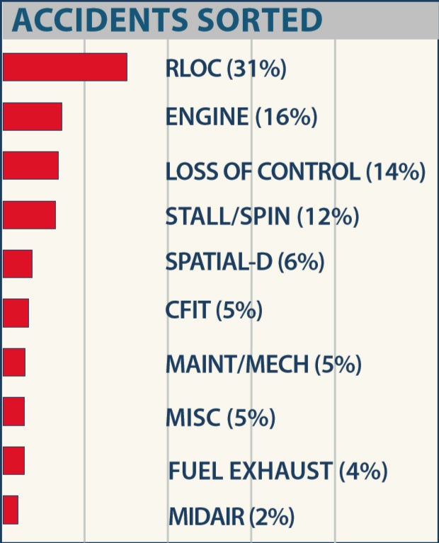

As shown at right, landing-related accidents play an outsized role in the Cirrus accident picture. We’re not sure if the Cirrus line has the highest incidence of runway loss-of-control (RLOC) accidents, but our long-term reviews of other aircraft find that the Bonanza and Cessna singles and retracts have a lower RLOC percentage. By model, Mooneys are sometimes comparable.
What’s relatively unique about Cirrus RLOCs is that they seem to occur at higher speeds and significantly damage the aircraft. While injuries aren’t common, we found at least a dozen that did involve slight to moderate injuries and one fatality. To be fair, we found similar accidents with other types, but they aren’t as numerous.
Complicating characterizing this accident type is that many involve a hard touchdown, followed by a go-around that goes bad because the pilot fails to counter the engine’s strong torque at low speed, causing the airplane to roll and catch a wing. These are often found on the left side of the runway. Some are described as stalls.
If we had a wish list for Cirrus aircraft, it would be better protection of the fuel. Postcrash fire is frequent, as it was in this crash. The pilot stalled after an aborted landing.
Speaking of which, despite the Cirrus stall-resistant split-incidence wing, the type does have a stall/spin presence. A handful of these were base-to-final turns; some were on departure or on some phase of the approach.
Otherwise, rounding out the Cirrus accident pattern are the usual suspects. Loss of control is garden variety upsets in turbulence or due to pilot distraction. More than one of these was saved by a CAPS deployment and the pilot lived to tell about it. Spatial disorientation as a cause appears to be comparable to other models, but again, the CAPS saved the day in some of these, where it is nearly always fatal in other models.
